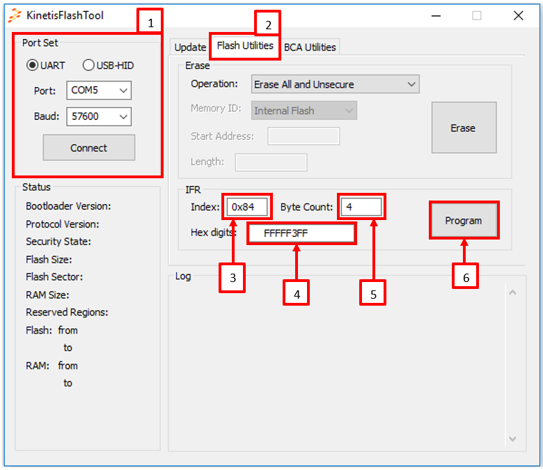

Option #1: Kinetis Flash Tool
Using the Kinetis Flash Tool is likely the most convenient method to change the IFR values.  The Kinetis Flash Tool uses either the UART or USB protocol to interface with the K32L3A6 bootloader and write the IFR fields desired. One of the biggest advantages for the Kinetis Flash Tool is that it provides a graphical interface for users to easily program the IFR fields. The following figure is a picture of the Kinetis Flash Tool and highlights the important input controls and tabs to be used when programming the IFR fields:
  1. This field is the Port set box.  It selects the interface (UART or USB) to be used when communicating to the bootloader.  This box also allows for configuration of the interface.  Consult the K32L3A6 reference manual for default configurations.
  2. This is the Flash Utilities tab.  Select this tab to see the controls shown in this image.
  3. This is the Index input field.  The Index of the IFR to program should be entered here.
  4. This is the Hex digits field.  This value will be programmed at the IFR Index indicated in the Index field. The value here should be in hex format WITHOUT the preceding "0x".
    1. Note that this will write to the FCCOBs in descending order.  For example, to write 0b'10 to the KEYEN field, FFFFFF00 should be written to the Hex digits field. Refer to the programming process outlined in the IFR Field Programming Process in this document for more information.
  5. This is the Byte Count field.  This tells the utility how many bytes to program and must be the byte count of that IFR field.  Consult the Erasable IFR Map table in the reference manual for the value of the specific IFR index to be programmed.
  6. This is the Program button.  After all of the fields have been filled out, click this button to program the desired IFR location.

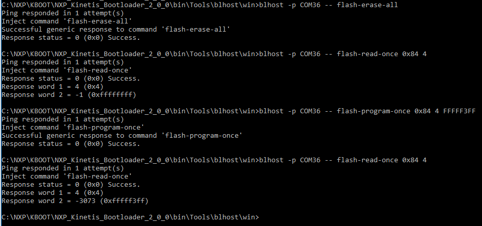

Option #2: BLHOST
The MCUBoot package also includes a command line executable to interface with the bootloader.  This tool, blhost, can be used to program the IFR fields as well.  The "flash-program-once" command should be used to program the desired IFR location.  The syntax of this command is as follows:
flash-program-once <index> <byteCount> <data>
So for example, if you want to program the FOPT IFR field (record index 0x84) with 0xFFFFF3FF, the correct syntax using this command would be
flash-program-once 0x84 4 FFFFF3FF
After programming, the "flash-read-once" command can be used to read back and verify the programmed IFR field(s).  Below is an example using the previous IFR locations
flash-read-once 0x84 4

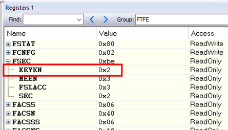

Below is a full example of erasing the device, programming the FOPT IFR, and reading the FOPT IFR back from the command line using blhost.
When Programming two byte fields, blhost orders the bytes in descending FCCOBx order (just like the Kinetis Flash Tool).  The blhost utility also requires the input to be 4 or 8 byte aligned, but the flash-program-once command only uses the last 2 bytes.  The upper 4 bytes can be padded with 0's or F's. For example, to write the KEYEN field such that the KEYEN bit field is 0b'10, the command would be as follows:
flash-program-once 0x83 4 FFFFFF00
Below is a full example of using the blhost command line to erase the device, program the KEYEN IFR, read the KEYEN IFR back, and evaluate the FSEC bit field using the Attach to Running Target function in a debugger.
After executing a pin reset and attaching to the running target:

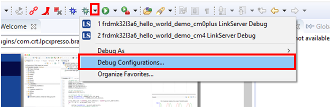

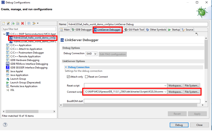

After the script is written, MCUXpresso must be told to use the connect script.  This is done in the Debug Configurations window.  Assuming a debug configuration has already been created, click on the arrow next to the green bug icon and select Debug Configurations.
In the resulting dialog box, select the debug configuration you want to use, and select the Linkserver Debug tab.  In the Connect Script field, point MCUXpresso to the location of your connect script.
That's all that needs to be done in the IDE. The selected debug configuration should now be using the script which was written.
