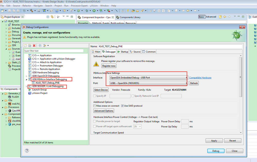

how do i upload my program to the samples

Hi Jack,
Could you tell us which IDE and MCU are you using?

jackmonaghan
IM using KDS and I'm using the KL43Z MCU

Hi Jack Monaghan,
      I don't know which programmer you are using, but the configuration in the KDS is nearly the same, you should choose the according debug interface, after you connect the programmer to your board with SWD interface,  then click debug, the program will download to your chip.
    Here, I take PE opensda as an example:
    In KDS, choose RUN-> debug configurations, then  choose GDB PEMicro Interface debugging-> KL43_TEST_Debug
    Choose the interface as your programmer(here is OPENSDA), then click button debug, wait the flash download finished, then your chip will be programmed.
Wish it helps you!
Any question, please contact me.
Jingjing
