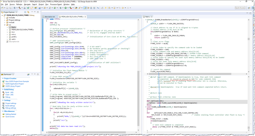

Hi, I use S32DS environment debugging TRK - KEA128 board Flash function, normal in debug mode can erase and write, but can't erase and write in normal mode, need to be copied into ram to run the program?

Hi JD Sun,
Please refer the FRDM_KEA128_FLASH_FTMRE example in FRDM-KEA-QSP.(...\FRDM-KEA-QSP\Quick Start Package v8\Code Project Examples and Sample Drivers (Evaluation Grade Only)\FRDM-KEAZ128\Driver Test SW for KEAZ128\Driver Test SW for KEAZ128\FRDM_KEA128_FLASH_FTMRE)

Thank you. What's the way to put Flash code into RAM?
