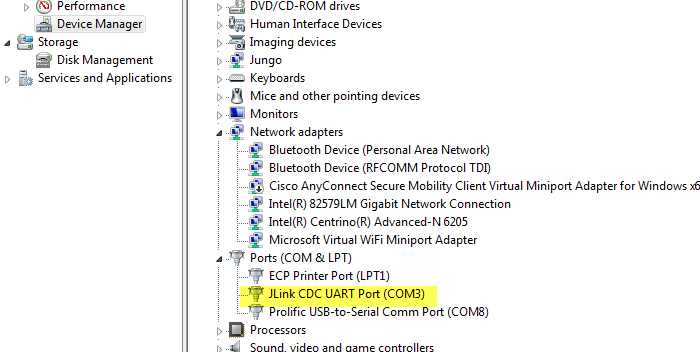

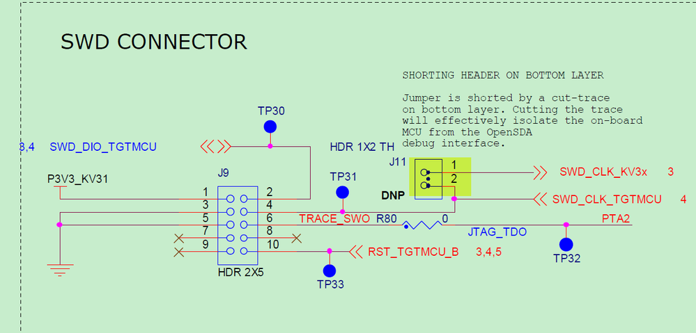

1. If you want to use the FRDM-KV31 as the JLINK debugger.
  You must cut the wire in the J11, you can find the wire between J11 in the back side of the FRDM-KV31 board.
Then you need to use the JLINK firmware, FRDM-KV31 on board opensda is the version 1.0.
So, please download JLINK firmare from this link:
SEGGER - The Embedded Experts - Downloads
Install the JLINK driver from this link:
(1) FRDM-KV31 power off, then press the reset button and hold on it, plug the board, you will find your board is a device named as "BOOTLOADER"
   Release the RESET button
(2) Send "OpenSDA_V1.bin" to your "BOOTLOADER", wait the sending is finished.
(3)Power off the board and power on it again, you will find your board is the JLINK device

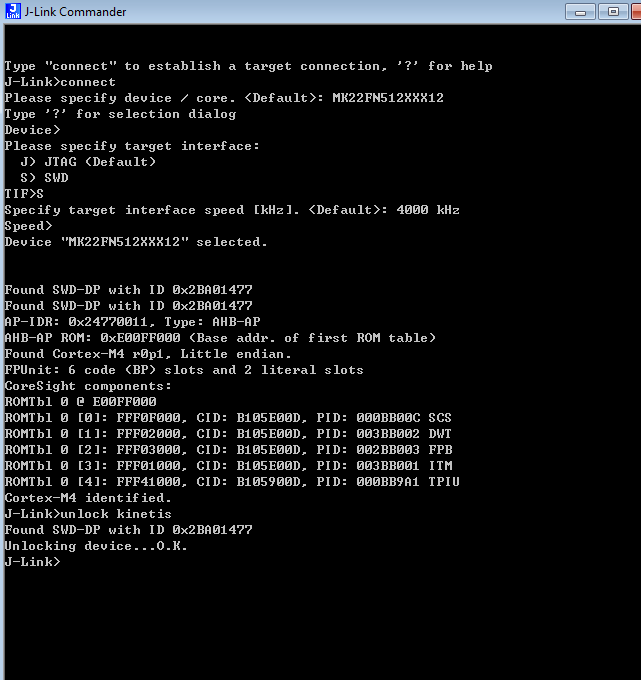

2. Use the JLINK commander to check whether it can connect your MK22FN512VLH12
I have connect it to the FRDM-K22 board which also has the MK22FN512VLH12 chip, it can recognize the chip with JLINK commander.
 >> You must cut the wire in the J11, you can find the wire between J11 in the back side of the FRDM-KV31 board.
I did this, I diconnected SWD-IO and SWD-CLK from the related unpopulated jumpers.
And here the problem begins. The J-Link sees the MCU  with SWD-DP ID0x2BA01477 as in your screen caption but is giving timeout error when tryin to unlock it. I also cannot apply erase command and gives error.
