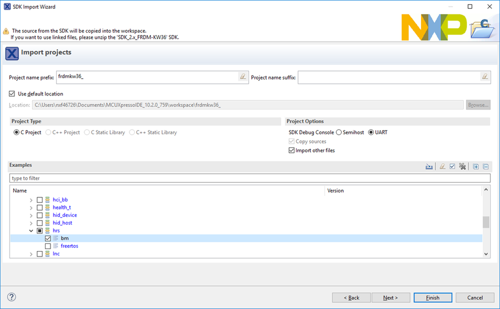

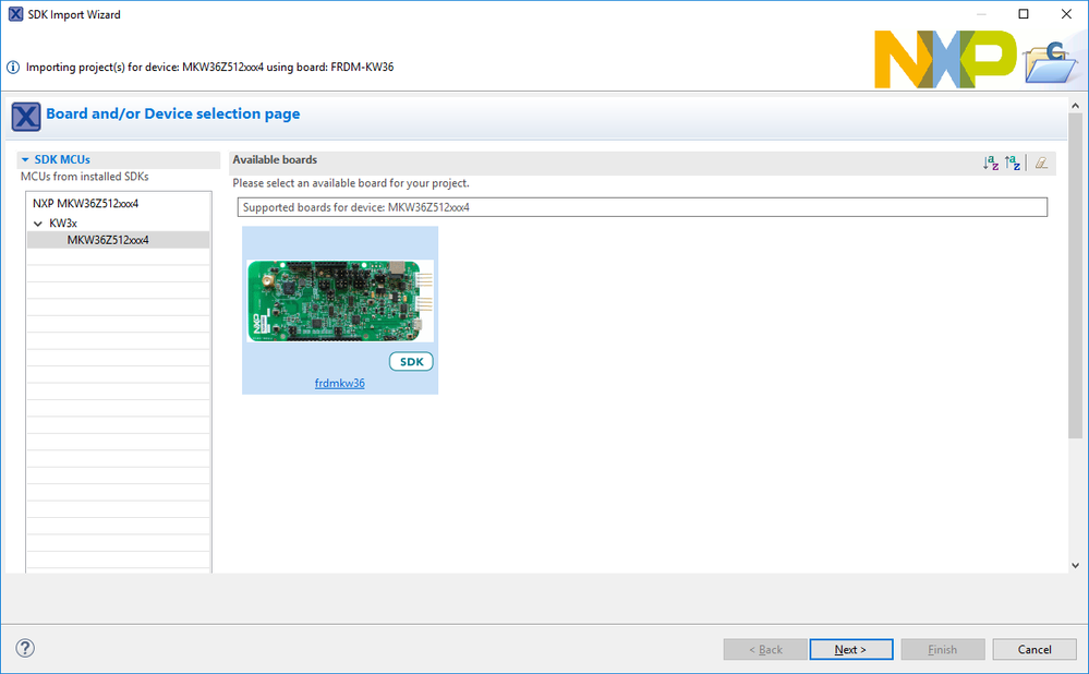

1. Select "Import SDK example(s)..." option in the "Quickstart Panel" window. Next, choose the FRDM-KW36 board. Click the "Next" button.
2. Expand "wireless_examples/bluetooth/hrs" folders and select bm project with the checkbox beside. Click the "Finish" button.

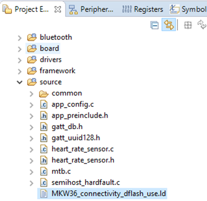

3. Replace the "MKW36Z512xxx4_connectivity.ld" file by "MKW36_connectivity_dflash_use.ld" (attached to this document) into the source folder in the workspace.

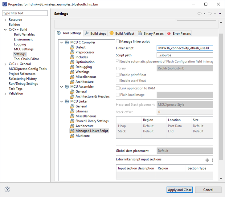

4. Open the "Project/Properties" window and select "C/C++Build/Settings". Next, go to the "MCU Linker/Managed Linker Script" perspective and edit the linker script name to "MKW36_connectivity_dflash_use.ld". Click "Apply and Close" button.

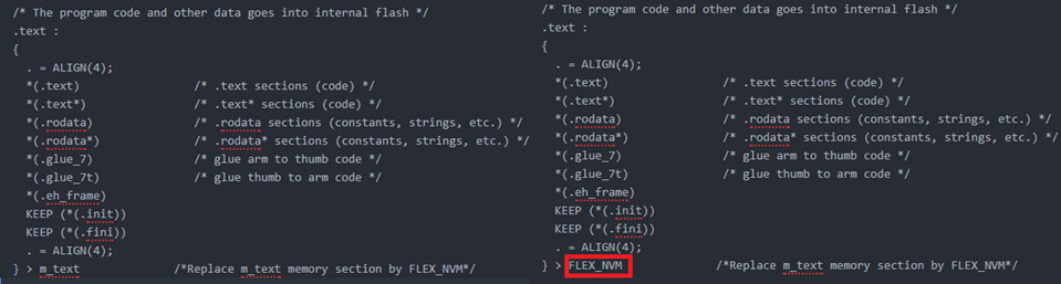

1. Open the "MKW36_connectivity_dflash_use.ld" linker file.
2. Search for output sections. In this example, we will edit the "text" section to save it in the FlexNVM array. Replace the "m_text" memory by "FLEX_NVM" memory as in the following picture.

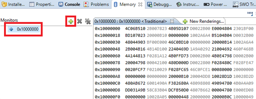

3. Debug the project using the CMSIS-DAP debugger.
4. Open the memory perspective. Add a new memory monitor with the "green plus icon" in the 0x1000_0000 address. Verify the expected results.

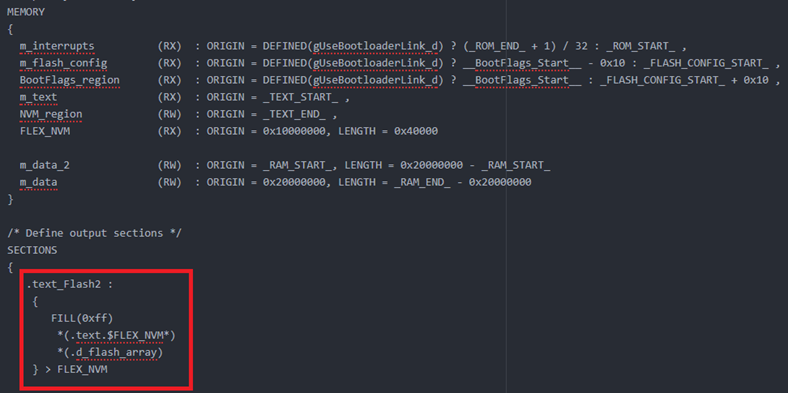

2. Search for output sections. In this example, we will create a new section placed at Flex NVM address range. The name of this output section is "text_Flash2". Edit the linker file as shown below.
3. Create your functions and variables using the following section attribute (in this example we will open and place the text below in the "fsl_os_abstraction_bm.c" file under framework/OSAbstraction/Source folder in the workspace):

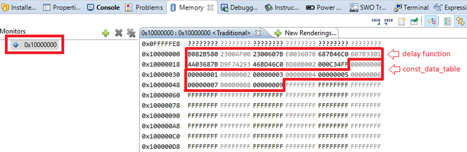

5. Debug the project using the CMSIS-DAP debugger.
6. Open the memory perspective. Add a new memory monitor with the "green plus icon" in the 0x1000_0000 address. Verify the expected results.
