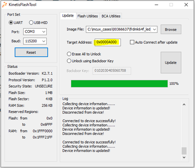

The short answer is : It is possible to program your K66 over UART with the Kinetis flash tool (or BLhost  utility)
Detailed answer is :  there are three kind of bootloaders within our Kinetis MCU:  Flash-resident , ROM resident and Flashloader. In the MCUboot  page, under the Supported Devices you will see which bootloader options are supported with our Kinetis MCUs.
The K66 does not have ROM resident bootloader, but it has Flash-resident bootloader , which  will reside  at  the beginning of the flash , reserving several KB of memory. If you consider to use this bootloader option , you must ensure that  application images are above  the bootloader  area, usually 0xA000 address.
Here I am making sure that my target application image is above the flash-resident bootloader area.
The flash-resident bootloader project for the MK66 can be found on the MCUxpresso SDK  and can be imported and flashed as a standard project ( we recommend to build the flash-loader  under release mode with optimizations to reduce its code size) .
When you have this resident bootloader you can load the binary of your application  (with its respective offset ) as you usually do.
Below you will find an snapshot of me using the Kinetis flash tool to load my a blinky binary at 0xA00 offset (with the FRDM-K64F). In my case I pressed the NMI pin, during reset to stop the bootloader from booting the application.
Please take a look at the documentation at MCUBOOT. Where we provide  further details
I hope this could help you.

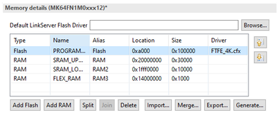

Regarding the creation of the image, there is a sample project that you can check frdmk66f_led_demo_freedom_a000 .  You can find its linker script directly following this path:  frdmk66f_led_demo_freedom_a000->middleware->mcu-boot.  (Depending your toolchain its location may change a bit, but that's for the MCUXpresso IDE)
I recommend you to take a look at the MCU Bootloader Demo Applications
User's Guide There you will find relevant information how to use the bootloader to load an application image. Also, regarding the 0xA000 offset for the image, chapter 7.1 Memory map overview will be useful to  visualize  the use of the memory by the application and the bootloader.
To move and application to the 0xA000 with ease, in the MCUXpresso IDE, you can go to project properties->MCU settings-> Memory details and adjust the base address of the flash.

   Thanks for you response but I still can not made my board  too bootloader mode.I tried to reprogramming the FW as blow I Programming both Freedeom_bootlaoder and led_demo_freedeom_a000. I've set update the start address for both led_demo_freedom_a000.
Set application image (led_demo_freedeom_a000)
        Set on project Explorer  Project_settings ==> Memory ==>edit memory ==> change flash location to 0xa000. Size to 0x200000.  Build image and create binary image
No change for the Freedeom_bootlaoder  and build image and create binary image.(start from 0x0000)
