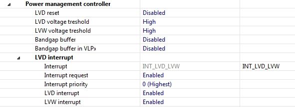

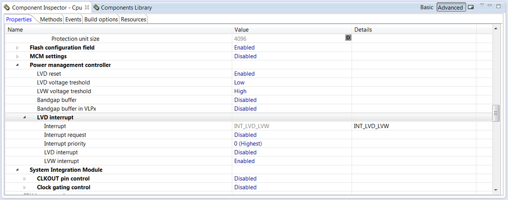

Hei,
we are trying to get the Low Voltage Detect Interrupt to work on the FRDM-KL26Z development kit, but no matter what settings we choose, the irq does not seem to fire.
Below are the settings for LVD in PEx:
And the service routine in Events.c - the "lowVoltage" is a flag that gets checked in the application:
void Cpu_OnLowVoltageINT(uint8_t Reason)
  /* Write your code here ... */
    PMC_LVDSC2 |= PMC_LVDSC2_LVWACK_MASK;
    lowVoltage = TRUE;
The "Cpu_OnLowVoltageINT" event is enabled in the CPU module:
Could someone provide a screenshot of working LVD settings in PEx ?
Thank you in advance for the help!
Dominik

Hello Dominik,
Please try disalbe "LVD reset" , and enable "Interrupt requesst " .
Alice

dominikf
Hei Alice,
we had tried the settings that you described as well, but without any luck. Would you have another idea of what we could try?
This is the settings as they are now:
Dominik

mike_susen
Hi Dominik,
Settings for LVD interrupt seems fine. But you cannot check LVD flag in your code because LVD flag is checked and cleared in Cpu.c code:
PE_ISR(Cpu_INT_LVD_LVWInterrupt)
  uint8_t Reason = 0x00U;              /* Defines the source of Low voltage interrupt */
  if ((PMC_LVDSC1 & PMC_LVDSC1_LVDF_MASK) != 0x00U) {
    PMC_LVDSC1 |= PMC_LVDSC1_LVDACK_MASK;
    Reason |= LVDSRC_LVD;
  if ((PMC_LVDSC2 & PMC_LVDSC2_LVWF_MASK) != 0x00U) {
    Reason |= LVDSRC_LVW;
  Cpu_OnLowVoltageINT(Reason);
So you can only check the Reason valuein Cpu_OnLowVoltageINT(uint8_t Reason) function. Reason value may acquire 0x00U or one of these two values.
#define LVDSRC_LVD        0x01U        /*!< Low voltage detect       */
#define LVDSRC_LVW        0x02U        /*!< Low-voltage warning      */
Michal

marek_neuzil
Hello Dominik,
I see two possible reasons of your issue:
- The bandgap buffer is disabled in your configuration of CPU (there is not any statement about the bandgap buffer usage by LVD in the refernce manual but the LVD can use the bandgap buffer for detection of the low voltage).
- The MCU supply voltage is regulated by an independent power source but other circuits (peripherals connected to the MCU) are supplied by a stable source of Vdd (3.3V). The MCU can be powered by these connected devices and the LVD detection circuit are not able detect the low voltage of MCU power supply. You should regulate voltage of the MCU and all connected circuits to detect the low voltage by the LVD device.
Marek Neuzil
4,835 Views
dominikf
Hei Marek,
thanks for the input, it is much appreciated.
Indeed the bandgap buffer is disabled. We will try this and report back, although it might take a bit until we have the time to do so.
Dominik
