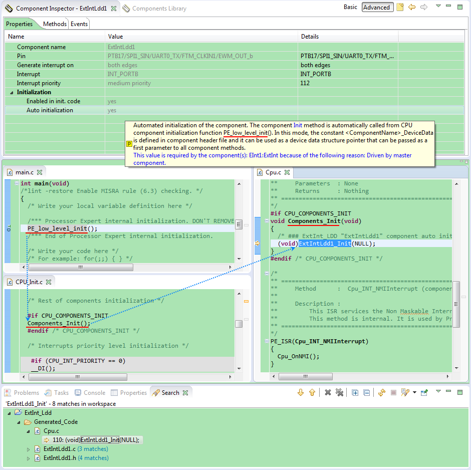

Robin_Shen
Hi Richard,
The initialization function is called in my project.(See the attached image)

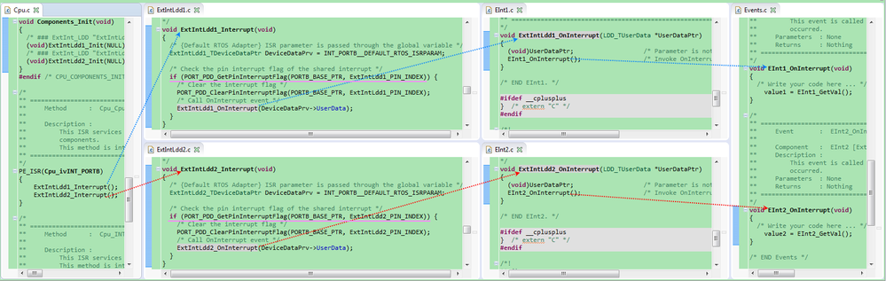

I am using 2 GPIOs in Port B to determine if a switch has been pressed. The first GPIO is for
on row in the switch matrix. The second GPIO is for another row (a different set of switches).
I have both GPIOs configured to interrupt on both edges of the switch press. The two GPIOs
should be independent. The first GPIO uses ExtLdd2, while the second one uses ExtLdd3.
I expected that there would be two distinct ISRs for the Ports. However, the CPU component
has set up both of the external interrupt components as one.
PE_ISR(Cpu_ivINT_PORTB)
   ExtIntLdd2_Interrupt();
   ExtIntLdd3_Interrupt();
So the first of my ISRs falls into the second ISR.
Somehow I need to have Processor Expert assign two different interrupt vectors for the two
components.Probably something that I misconfigured.

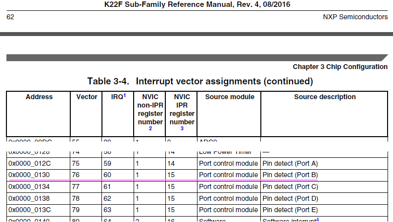

Robin_Shen
Hi Richard,
All Ports have their own ISR(interrupt vector). If you need to have Processor Expert assign two different interrupt vectors for the two components, please use two different Ports.(for example:one GPIO in Port B and the other GPIO in Port C)
If you using 2 GPIOs in Port B, the code will "Check the pin interrupt flag of the shared interrupt" to determine which switch caused the PE_ISR(Cpu_ivINT_PORTB).

Robin_Shen
Hi Richard,
Which "generated code" do you want to understand?  Do you mean PE_ISR(Cpu_ivINT_PORTB)?
The ISF bit in PORTx_PCRn is used to determine which GPIO caused the interrupt of Port B. You can see the  code(pink line) in attached image at my last reply. If the interrupt is caused by ExtIntLdd2_Interrupt, the code will still run into ExtIntLdd1_Interrupt to check the pin interrupt flag(ISF of PORTx_PCRn) first. And then run into ExtIntLdd2_Interrupt to chenk the the second pin interrupt flag.
If you still need to have Processor Expert assign two different interrupt vectors for the two components? The Port B has only one interrupt vector, all the GPIOs in Port B share this interrupt vector. So if you still need two different interrupt vectors for the two components, you need to use two GPIOs in different Port.
