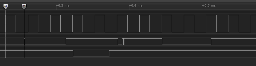

Hi all,
im trying to setup the FRDM-K22 board, to use VLPS mode running off the external 32k xtal, using the LPTMR to interupt and wake up at 8192Hz.  The LPTMR IRQ will be kept less than 30us.
i have set up the ERCLK32K to be output on pin PTE0, and set the LPTMR IRQ to pulse another GPIO.

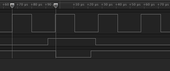

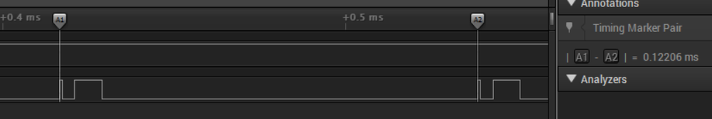

I can see them both on the scope, the gpio shows a 20us pulse, every 122us, and the clock shows 32kHz.
The current consumption is 1.22mA, which is very high, but im not sure where im going wrong?
I used BOARD_BootClockVLPR() from the example code, then use SMC_SetPowerModeVlps(SMC) in the main while loop.
I expected to see that the scope pin would go high every fourth clock period, with a small delay. But, there is a lot of jitter.
  • if i trigger from the 32k clock, the gpio pin trace does not seem synced at all.
  • if i increase the trigger holdoff there is a range which gets it in sync, and there is a 23us delay from the clock rising edge to the gpio pin rising edge.
  • If i trigger from the gpio pin, the clock jitters a little, and there is also the 23us delay from the clock rising edge to the gpio pin rising edge.
Is the large delay to be expected? something to do with the delay in the NVIC?  i tried in VLPW and VLPR and got the same 23us delay.
I cant use the debugger as it wont let me get into VLPS mode (i get a 'STOPA' error).
Can anyone give any ideas?

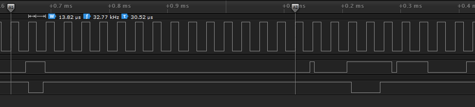

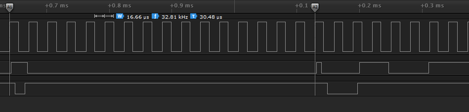

These are my analyser shot as comparison:
The top is of course the 32kHz clock.
The falling edge on the lower trace is the IRQ that the LPTMR triggers (and the delay from the clock's rising edge to it is 12us). This low pulse is the uTasker OS TICK handler, which will schedule a task (that runs at every tick).
The middle trace shows the instruction just after moving back from VLPS to RUN (immediate rising edge) - it then enables interrupts so that the interrupt that woke from the VLPS mode can actually fire (the VLPS state needs to be entered with disabled interrupts to avoid risk of system failure!!).
The middle trace toggles (low) again in the task that is scheduled.
It is interesting to note that the delay from the LPTMR wakeup and the task being scheduled is also very exact/consistent due to the fact that there is no randomness (the wake up always continues from the exact same code location after the IRQ). The OS will set the low power state after the task has run, it has verified that nothing else needs to be executed and it is safe to sleep again - the middle trace goes high again when the next VLPS state is commanded.
The reason why I set 500us period (and not 122us) is because the complete cycle is around 170us due to the OS operation and if I set it lower it will not be able to sleep since the next LPTMS Tick already arrives before it can. The ratio of VLPS and RUN is then also not of interest because it will be in RUN mode too much of the time (percentage).
This raises another interesting question which is also a frequent subject in low power designs. You have set a very slow processor clock and it is causes the OS operation (since it has too many timers, queues, tasks to be checked in my configuration) to take either too long or a high percentage of the cycle period. The result is a high percentage in RUN and only a small benefit from the VLPS (or other) mode. This can be quite inefficient.
The other strategy is to sleep deep for as long as possible, then run "as fast as possible" (to keep RUN time short) to get back to sleep as soon as possible. Then there is a high percentage of low power in the cycle - a high short current peak but an average consumption which is still very low.
Which ever chip you finally go for you may find it useful to consider which strategy is actually best based on the specific application and its cycle requirements. The advantage of the uTasker project is that I can run the exact same method on any Kinetsi (K, KL, etc.) without any changes (apart for the board define and clock speeds) so I can just chose the type that is finally used whenever it has been identified.
Probably in this design I would not have any tasks and do the IRQ handling directly in the interrupt.
Alternatively it is in fact not even necessary to have an interrupt (in the cycling case and single wake up source) since the handling code can immediately be executed after the sleep instruction, thus even saving interrupt latency!
Tell me how you get on and if you see anything else worth investigating further.

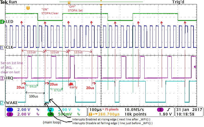

Thanks for helping out on this. Its really helpful. Disabling interrupts before vlps rings a bell, why is this? I've added it in, and added another gpio for the main loop 'WAKE' which goes high immediately after _WFI(), and low immediately before.
attached image - this time the led is showing yellow so i knew it was switching quickly between red and green. i can see that as you suggested things are taking too long.
the third 'IRQ pulse' comes early because it has not went back to sleep or disabled interupts yet. the LED shows that STOPA is set just before this.
I had set the Flash to 1MHz which i gues isnt helping if it needs to be <800KHz. maybe this is what is holding it up so much?
i will try to rework things to use the FLL at higher frequency. I'm aware of the low power schemes your suggesting and am planning on doing this.

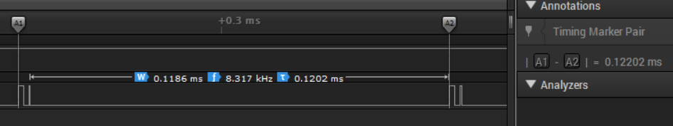

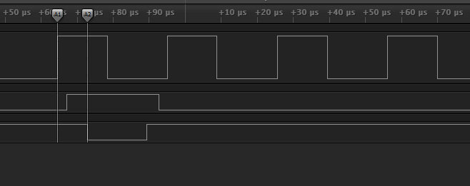

As reference to what is achievable in VLPS and LLS when I move to low power cycle mode (that is I allow the low power loop to bypass the OS) I have the following recordings. I can switch between automatic mode and the OS bypassed mode as I want (eg. if I have a UART based command line exists I can run in the optimised loop to save most power but if I detect a UART interrupt pending I can temporarily switch to the full OS operation to handle the interaction with the user before returning to the optimised loop mode again.
In both cases I have the wake-up taking place on a LPTMR match, a virtual interrupt handler executing (I write "virtual" because the wake up was due to a pending interrupt and I never enable interrupt or have the interrupt latency involved).
Then it shows this cycle followed by a cycle which quits the loop to schedule tasks and such (which then needs to take the interrupt vector).
VLPS (close up)
1. LPTMR edge to processor executing instructions = 2us
2. Virtual interrupt handling taking place (bottom trace) 6us later
3. I have a short routine that just clears interrupts and does a counting function to set the mode back after a while takes 16us (shown further below)
4. VLPS mode entered again 3us after the handling is complete.
Therefore no interrupt latency and the RUN time is kept as short as possible
VLPS (low power cycle followed by 'normal' OS mode after the next wakeup)
The main observation is the interrupt latency and of course the OS overhead to schedule tasks and return back to the VLPS state (with its advantages at complete system level but as a trade off in that period). The recording in this section has been discussed in detail in previous posts.
LLS (closeup)
The wake-up time from LLS to RUN is much longer (25us as opposed to 2us) but the rest is the same as in the previous case since there is no interrupt latency issues (see next for comparison).
LLS(low power cycle followed by 'normal' OS mode after the next wakeup)
The delay between wakeup event and the start of handling it increases from 30us to 96us due to the interrupt latency (in second cycle).
This gives quite a good insight into the advantage of being able to control the RUN handling in such a cycle without needing to handle interrupts. It reduces the ratio of RUN to VLPS or LLS importantly and so can allow overall current to be reduced quite significantly (due to removal of interrupt latency overhead, especially after LLS wakeup!).

I have performed some tests in LLS3 and have some interesting findings.
There is now a delay similar to the one that you measured.
Also note that in VLPS mode there is no problem with the debugger - only in LLS is it no longer possible to work with it.
These make me believe that you are somehow confusing LLS with VLPS.
The LLS wake up is however not as expected! This is what it now looks like:
The first marker is the edge which I believe wakes the processor from LLS mode. Now it takes 25.2us for the first instruction to be executed after waking, which is a lot longer than the max. 6us quoted in the data sheet; although the value in the data sheet if for 80MHz which suggests that our 4MHz clock is slowing recovery!
The next very surprising fact is that the wake up interrupt that caused the LLS to RUN recovery has a latency of  56us!!!!!!. I proved that the processor is executing instructions at the normal speed before taking the interrupt but it is much slower than when an interrupt is (normally) taken (typically around 8us with FPU state saving).
The second trace going high signals that the wakeup interrupt (due to LPTMR wakeup module) has been reached. This calls the OS tick handler (since the LPTMR interrupt is also pending anyway) and clears the sources - the bottom trace shows the actual tick handler being called from the LLWU interrupt.
Although not as extreme as when the interrupt is taken, returning from the LLWU interrupt also takes about twice as long as normal. This makes me wonder whether this exception is special in some way and is having to save and recover more information that other interrupts (?). In any case it looks to be similar to the approx. 23us that you have been puzzling over. In fact from the rising edge of CLKOUT32k to the IRQ I get about 82us, which means that you may be measuring from the wrong edge - the trigger was in fact 2 clock cycles before the one that you start measuring from !
The second trace flips bits for a while (I used this to prove that the interrupt is taken immediately and any slowness is not due to the interrupt being delayed - the bit flipping speed is the expected instruction speed). The rest is then as before.
Therefore I can show the operations in and out of VLPS and LLS3 to be basically equivalent in terms of the behavior flow but LLS3 recovery is taking unexpectedly long!
In fact, the LLS3 saving of current (about factor 3 over VLPS) is deteriorated due to the longer time that it takes to do the work in this sort of environment (quickly repeated cycle where the percentage of time in RUN should be kept as low as possible).
My feeling is therefore that VLPS is the one to go with (when the % of the period is fairly high. I would also look at running as fast as possible when in RUN to keep the time short. This may also help LLS performance since the LLWU interrupt latency should also be much better (it is presently dead-time which is consuming RUN mode current but does very little useful work that is visible and of any importance to the application). Also I would seriously consider a part without FPU to keep latency as low as possible.
If you have only one interrupt that does the cyclic work no interrupt is needed (as explained in previous post) and thus interrupt latency can be removed altogether.
Mark

Also, i tried new code, stripped down. I tried without VLPS, ie i booted to normal run mode. then:
while (1)
  /* Tmr setup for IRQ, so can go to sleep here */
  APP_goToSleep();
  if( schedule_1_flag )
  currentCounter = lptmrCounter;
  schedule_1_flag = false;
  //PRINTF("\r\nirq#%d \r\n", currentCounter); ;
  //APP_setLedColour(debugLedColour);
inline void APP_goToSleep(void)
    SCB->SCR |= SCB_SCR_SLEEPDEEP_Msk;
    __disable_interrupt();
    //SMC->PMCTRL &= ~SMC_PMCTRL_STOPM_MASK; //temp - 0 is normal stop
    // SMC->PMCTRL &= ~SMC_PMCTRL_STOPM_MASK;
    // SMC->PMCTRL |= (2U); //temp - short as poss
    /* Go To Sleep */
    GPIOB->PCOR = 0x00010000; //PTB16 temp - short as poss.
    /* read back to make sure the configuration valid before enter stop mode */
    (void)SMC->PMCTRL; //arm doesnt wait for previous line before wfi...
    __WFI();
    /* Wake Up */
    GPIOB->PSOR = 0x00010000; //PTB16 temp - short as poss.
    __enable_interrupt();
    /* check whether the power mode enter VLPS mode succeed */
    if (SMC->PMCTRL & SMC_PMCTRL_STOPA_MASK)
        //debugLedColour = kLED_RED;
        APP_debugLED_RED();
    else
        //debugLedColour = kLED_GREEN;
        APP_debugLED_GREEN();
its really weird, it is a lot cleaner, but:
with the debugger - the irq works every 4th clock as expected,
without the debugger it now triggers every 20th clock!?
I have attached pictures to explain.
I then when back to VLPS and the irq is every 4th cycle with or without debugger, but has the previous problem ("yellow STOPA LED").
