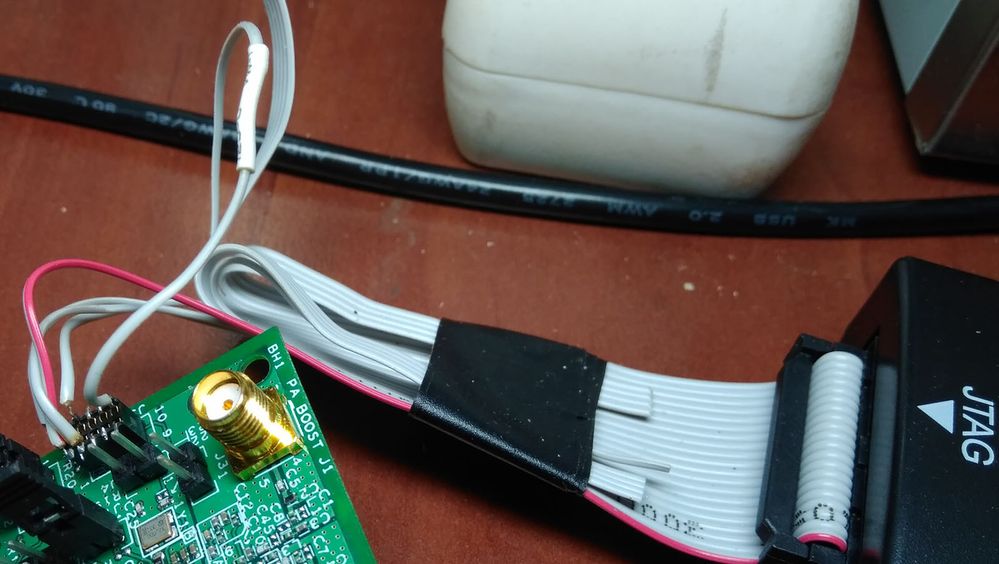

Hello, I’m having a problem with connect to MKW01Z128 on MRB-KW019032EU board. I took the J-Link, connect it to J5 on MRB (VTref to 1, GND to 3, SWDIO to 2, SWCLK to 4, RESET to 10).

But when I try to perform any operation with board (i.e. erase flash, download) from within IAR, I'm getting the following fault: "Failed to read CPUID for Cortex device. "

Is this issue only present on this board? Do you have another MRB-KW01 board to verify this? I would recommend using a J-Link 9-Pin Cortex-M Adapter to ensure that the connections aren't loose.
Can you try the "unlock kinetis" command to make sure that the chip is unsecured before trying to erase the chip? The unlock kinetis command will trigger a mass erase and clear the security bits in the KW01.
Also, it would be helpful to test this in another computer too see if the behavior is the same.

alexandrsmirnov
Thank you for support. The problem was in the faulty J-Link.
I managed to flash an example from KSDK when I used another J-Link. :smileyhappy:
