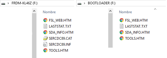

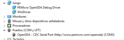

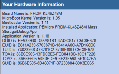

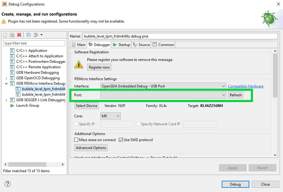

   I can't debug in Windows 10, works fine in Windows 7, dont recognize the board.
Info:
      *Windows 10
      *Board: FRDM-KL46Z
      *OpenSDA
      *Kinetis Design Studio 3
And some pictures
And finally, when I plug it in without pressing the reset button///when I plug it in pressing the reset button(Bootload mode)
What I missing?
Thank you, regards and sory for the bad english...
2,078 Views
BlackNight
Everything looks fine, and the drivers are present in your system too.
I guess you already tried with unplugging the board and trying it again (and press the 'Refresh button in that dialog)?
I hope this helps,
Erich
2,078 Views
ulisesserri
Yes, several times
EDIT:
SOLVED!!!! I delete P&E Device Drivers, delete the C:\PEMicro folder and install again, its working...Thanks
