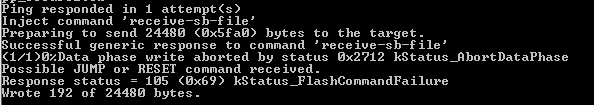

I have created a secure binary file using elftosb utility with the following *.bd file
#Adding the sources in the Command file
sources {
   CIU_app="ISS_CIU_App.out";
section (0) {
erase 40K..42K;
load CIU_app;
reset;
further I use the following command to invoke the elftosb utility
elftosb -V -c Cmd_file.bd -z -o app_secure.sb
I am using the default zeroed key for encryption as it is mentioned in the mannual that the key need to written in the harware too??
After the app_secure.sb file is generated I am trying to flash it using the blhost utility with the following invokation
blhost -p COM3 receive-sb-file C:\app_secure.sb
After this I get the following error which I cant understand
What does this error means?? I have not used any jump command in my Cmd_file.bd

The Issue was incomplete knowledge of subject.
The Section being erased doesn't have any relation to the absolute address where the encrypt image goes in my design, also I am missing .srec, qspi_config_block.bin, hence the qspi is a must for this, which I didn't wanted to use as I wanted the Image to go on internal flash.
In other words I wanted to encrypt Application binary using key blob(as seen in *.bd file), but wanted to flash it into internal Flash, which is generally out of the scope of NXP Kinetis Bootloader Utility (elftosb). For following the other way you must use what Kerry described in her reply and flash encrypted file on external flash. (.srec, .bd, .sb. qspi_config_block.bin)
Hence the *.bd file is suitable for Encrypting Application on External Flash.
I achieved my target but I have to reinvent the whole wheel.

When I use the commands
I get an error that JUMP and RESET encountered (even though I have not give any JUMP Command)
