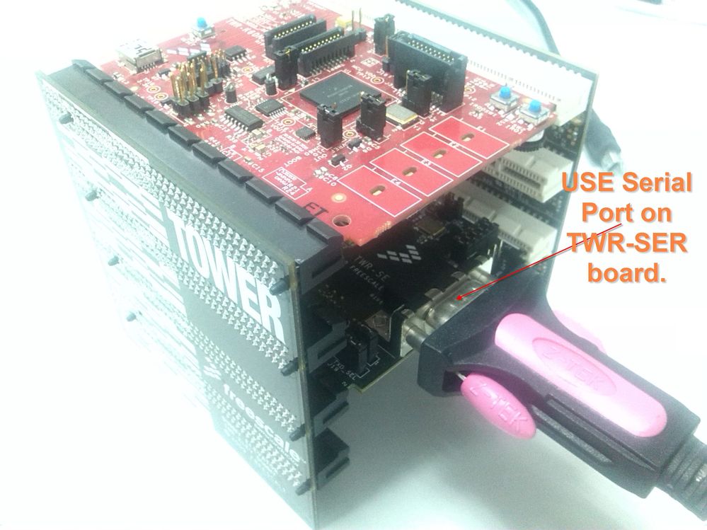

Hui_Ma
Hi Fernando,
The TWR-K60N512 board provides two serial port connection, one is on board OSBDM (USB CDC serial port UART5), the other one need to connect with TWR-SER board (UART3).
For the AN2295 is using UART3, which need to use serial port on TWR-SER board. And I check the latest AN2295 software, the baud rate is 9600.
Wish it helps.
13,449 Views
feraro
Hi Hui_Ma.
Thanks for the reply
I'm testing with the Tower and the serial port UART3. I have win_hc08sprg.exe program, set to 9600 baud and marking Short TRIM. Now show me the following message: "The maximum attemps to try calibrate clocks reached. Baudrate Try again with diffrent settings.".
I tried with different baud setting, but some do not receive the ACK and other continuous showing the same message.
What can be the reason for this?
Regards.
Fernando
