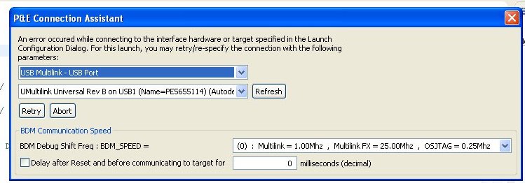

The result is that after some programmings, using PE Micro U-MULTILINK with SWD connection, che controller become non-programmable anymore.
Programming procedure's log reports the error "Memory secured" (or "Memory protected", I'm sorry but I cant remeber precisly...).
So, I have a dubt: before start programming, shouldn't the MULTILINK do a controller reset and, consequently, gets control on programming lines?
Moreover and seriously bad, after some attempts, the debbuger got broken...!

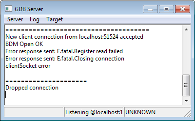

It seems that PE Multilink isnt able to reset the device, when ports PTA4 and PTC4 are configured as GPIOs: in fact, just I said before, we added a reset button between RESET and GND; if we do a reset with the button, and then we start to program with Multilink, it works!
I attach a schematic of connections in our board, and some of the errors that occurs when we program with CW 10.6.
Thanks a lot for helping.
