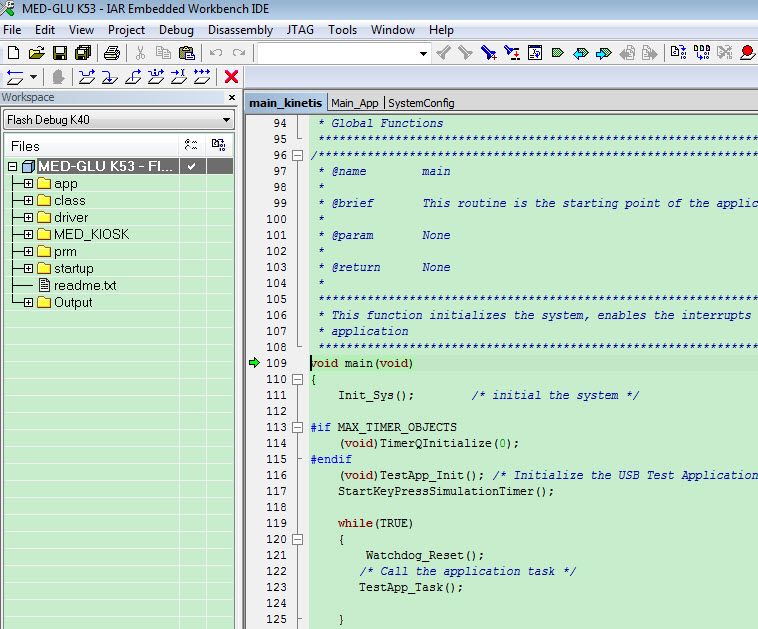

There is a problem showing at the time of debugging the program MED-GLU to the tower kit (MK53N512), I have attached the screen shot of the problem. And there is no any flash loader in debugger at the options. So please help me to resolve this problem asap.

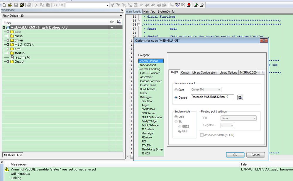

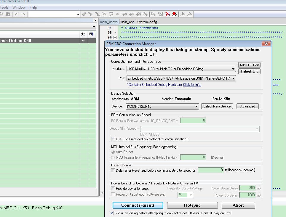

Hi Nimmi Satheendran,
    Please follow my step to configure your IAR project again, please see the following picture:
You will find, after choose the correct chip in the options, I can enter the debug, even don't choose the .board file.
Wish it helps you!

nimmisatheendra
Hi Jingjing Zhou,Jingjing Zhou
Debugging error is cleared and the program flashed to the tower kit succesfully...Thank you..
