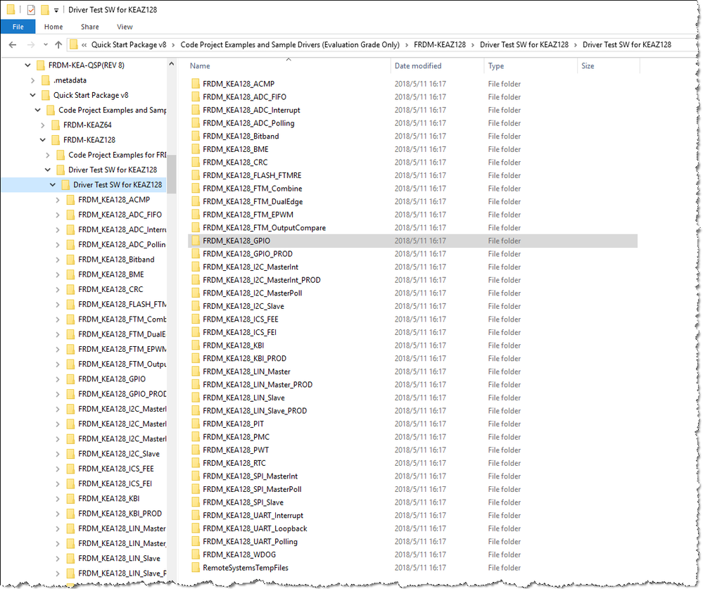

You can download the FRDM-KEA Quick start package(REV 8) from FRDM-KEAZ128 webpage.
Then please refer the FRDM_KEA128_GPIO in it's folder.(C:\Quick Start Package v8\Code Project Examples and Sample Drivers (Evaluation Grade Only)\FRDM-KEAZ128\Driver Test SW for KEAZ128\Driver Test SW for KEAZ128\FRDM_KEA128_GPIO)

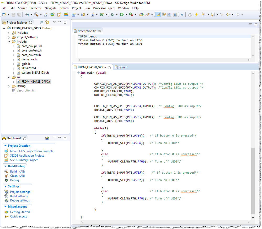

shravansrinivas
I followed the steps you mentioned above.
Problem in multiple conditions in if loop. I suppose it is not reading inputs and it is not entering "if" condition.
Please suggest a solution to use multiple conditions in IF condition.
if(!READ_INPUT(PTE,PTE0) && !READ_INPUT(PTE,PTE1) && !READ_INPUT(PTE,PTE2) && !READ_INPUT(PTE,PTE3) && !READ_INPUT(PTD,PTD4) && !READ_INPUT(PTD,PTD5) )
