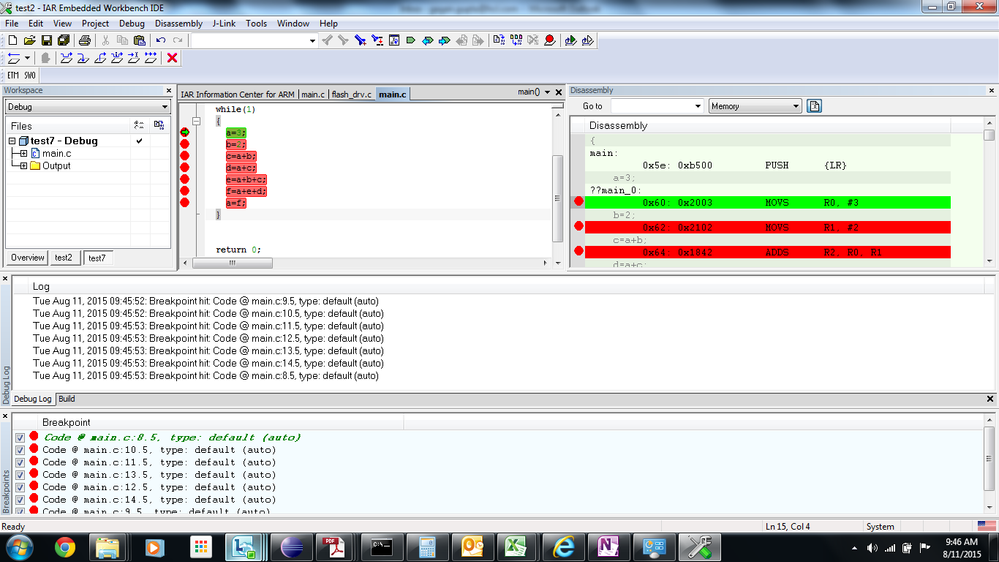

Hi, We are using MKE04z128 micro-controller with IAR compiler and jlink plus programmer. During debugging, if we set more than 2 breakpoint in our code, our application stops working and displays error message "Timeout during programming sector, core does stop and my application hangs and i need to reload the code into the board.
I know that there is only two hardware breakpoint but microcontroller should allow software breakpoint during debugging.

Hi, I am using Jlink Plus which is allowing me to put more than 2 breakpoint and see my below workspace.
Jlink Base allows you to use only two breakpoint.
In the above workspace, I can set as many breakpoint as required.
However if i tried the same with my code, debugger stops and gives me error message which I mentioned in my original post.
I am wondering what could be the difference between my code and the above test code.

jay_heng
Try to debug your code in RAM if you want unlimited breakpoint.
If the resource of MCU breakpoint unit has been occupied by hardware breakpoints, then you won't be able to set any software breakpoint. maybe this is the reason why the test code can work with more breakpoints but your code can't.

jeremyzhou
Hi Gagan,
There are two types of breakpoint, one is hardware breakpoint which has limitation in number , the other is software breakpoint.
J-Link PLUS support unlimited breakpoint in the flash memory which belongs to the software breakpoint.
So you can set more than 2 breakpoint in the code above, however failed to set in this sort of code which operates some hardware units inside MCU.

ndavies
Contributor V
Software breakpoints will not work on code in flash memory. Software breakpoints work by replacing code in memory with a breakpoint command. To insert the breakpoint in flash memory,  you would have to erase an entire sector and rewrite it with the breakpoint command in place. To erase the breakpoint you would need to once again erase the entire sector and replace the code that was originally there.
This is the reason hardware breakpoints exist. If you could easily replace the opcodes in memory, hardware breakpoints wouldn't be needed.
