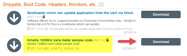

EarlOrlando
Senior Contributor II
Hello Francois,
I've been reviewing your code but I can't find what is wrong. However, The LCDC module does not need to be disabled to clear/set the LCDC_LGWCR[GWE] bit. Please try to enable/disable the Graphic Window without disable the LCDC module. Please confirm if this works.
Besides to enable/disable the Graphic Window, do you need to enable/disable the LCDC module?
Also, I compared your code with the demo provided in the Kinetis 120MHz bare metal sample code package which can be downloaded from Kinetis K70 120 MHz Tower System Module|Freescale. I think that this demo could be useful for you even if another problem arises.
Earl.
