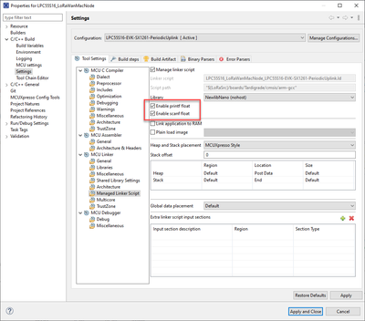

Hello, I am using MKL27Z256LH4 MCU  with MCUXpresso IDE_v11.4.1. in PRINTF I can get only decimals but I can not print floating numbers. How to print the floating number??

For some background: https://mcuoneclipse.com/2014/07/11/printf-and-scanf-with-gnu-arm-libraries/
I hope this helps
Erich
