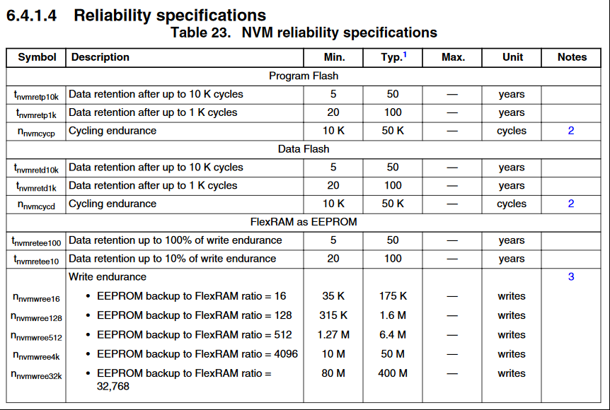

When using k10dx256, the sector of 1k of internal flash has reached the end of its life. I am trying to change to another sector and I am worried about preserving the data. I wonder if data retention, like lifetime, is guaranteed differently by sector.

The specifications we can guarantee are not divided by sectors, please check the table below:
Hope it helps!
