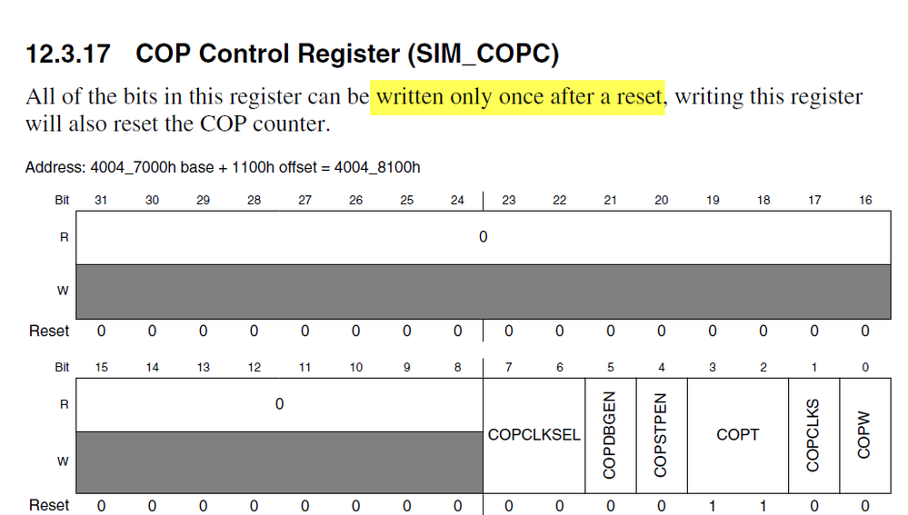

I'm using a Kinetis KL17 with FreeRTOS.
My code keeps resetting itself, according to the registers this is because of a watchdog reset, in the RCM registers SRS0  and SRS1 only the WDOG bit is set. However I've don't have the Watchdog enabled, so it can't be a watchdog that's causing this reset (COPT in SIM_COPC is set to 00). So any suggestions on how I can track down what's actually causing the reset?

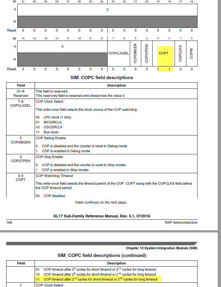

Hi Ben,
   Please check this register description in the KL17 reference manual:
You can find, after reset, COPT is not 0, it means, the watchdog is enabled automatically after reset, if you don't want to use it, you need to disable it in your code after power on.
I think in your code, you didn't disable the watchdog, then you also didn't feed the dog, so you will have the watchdog reset.
Wish it helps you!
Kerry

Got it sorted now.
The solution was:
  • When I said the watchdog wasn't enabled I'd simply commented out the lines in my code that initialised the watchdog (and kicked/refreshed it). I didn't explicitly disable it.
  • However even with my code to refresh it - I was still getting watch dog resets.
  • Moving my watchdog initilisation code to much earlier in my code seems to stop the watchdog resets.
So there must be something that changes with the watchdog clocking when going into VLPW mode.
