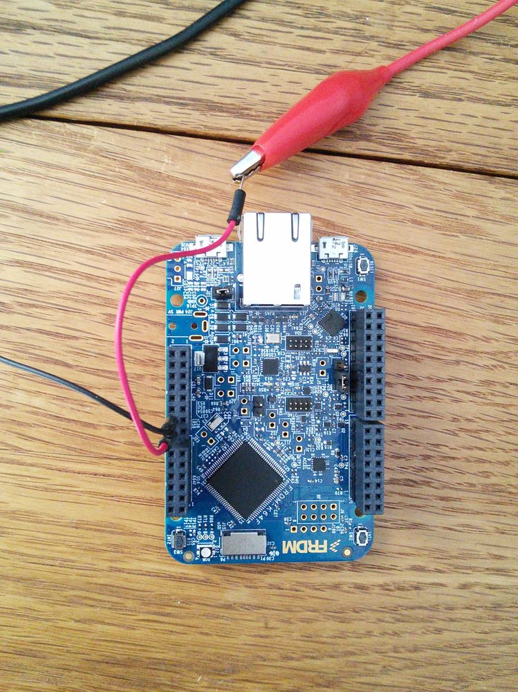

I've got a FRDM-K64F that I want to power up using an external power source. I put 5V through V_in (pin 16) and the connected the ground to my voltage regulator. I can see the Ethernet light turn on, indicating there is some power going through, but the main 'on' light isn't on, and nothing happens when I press the 'reset' button.
To double check that is meant to work, I connected it to my PC using the USB, hit 'reset', and it worked fine.
How can I run this with an external power supply?
Thanks!

michaelkoller
Hey there!
I have run into the same problem as OP and I have tried two things.
I tried my power supply Voltcraft VLP-1405 with 5V and I have tried the 5V which are supplied from a DC/DC stepdown converter, that I ultimately want to use.
There is only the red light on, as the OP reported, not the green one.
Which steps can I take to avoid this?

maksim_lipskiy
H.!
I made a smooth flow of power to the power was set for 100 milliseconds.

Before I answer your question, I'd like to check with you about whether you connected the external 5V supply to VDD pin directly or not.
Ping
3,477 Views
fahimrahman
I believe so, yes. 5V to pin 16, ground to pin 14.

Hi Hi Fahim,
I've reproduce your procedure to supply the board from a external 5 voltage, however the board can work well, as the Fig 1 illustrates.

maksim_lipskiy
Your DC power very long risetime (for example  DC-HY5002 about 400 ms). Therefore, the board is working.
If you are using a power supply unit SPS-026-05, the board will not work. Because risetime very small.
