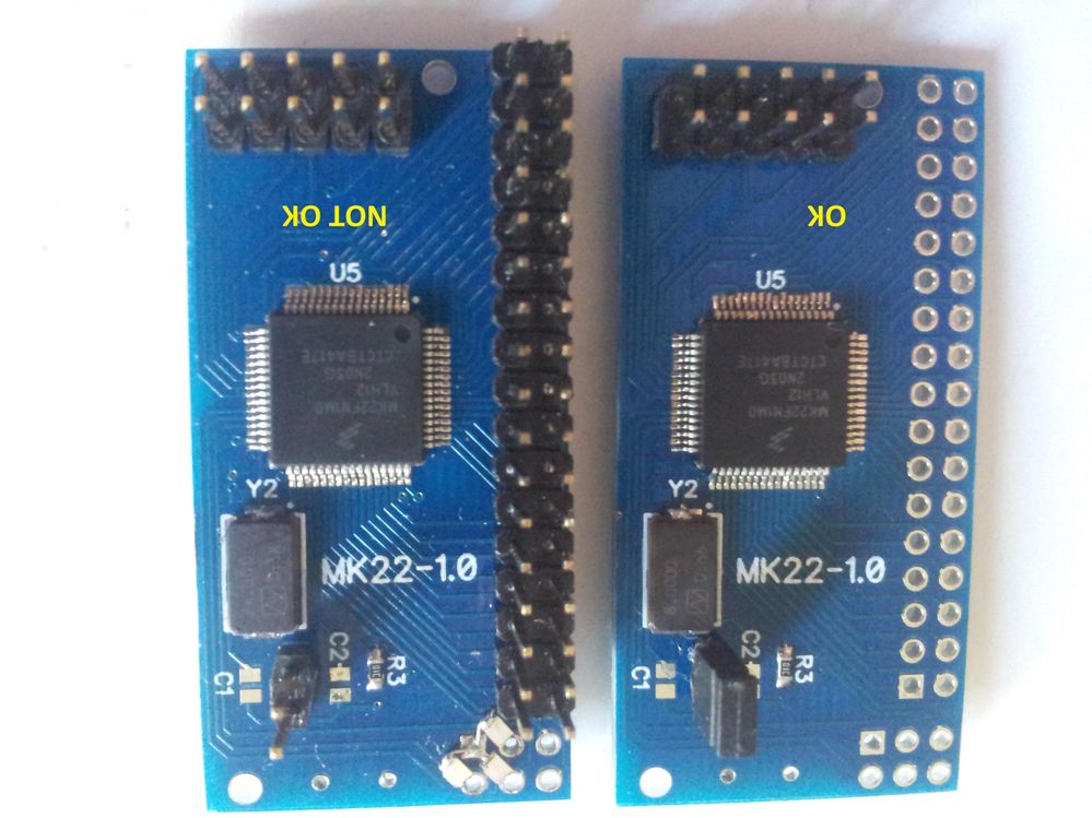

I made 2 custom PCBs (MK22FN1M0VLH12), both have USB connector, routing is almost the same. Both PCBs are working fine, the firmware is absolutely the same inside both MCUs.
BUT, as soon as I connect a USB cable to PCB A, it stops working, generates hard fault (could be bus or usage fault), while PCB B is working fine and USB functionality works as expected.
Measures taken to solve the issue:
  • At the beginning I put 51Ohms terminator resistors on both PCBs. In this stage PCB A does not work, PCB B works fine.
  • Then I changed resistors to 33Ohms (as recommended) on PCB A, did not help.
  • Then I tried to remove resistors and short cut on PCB A, did not help, so I moved back to 33 Ohms.
  • Then I enabled MPU on PCB A and saw generates MPU errors, this is just an additional information
I attached pictures that show how PCBs are routed.
I need some ideas what to try more? Should I add pull-down 15kOhm resistors to data lines?

yuriydovgalyuk
FINALLY!!!
Finally I confirmed the problem is in MCU hardware.
I used same CPU but from another batch, and it worked perfectly...
If you look at the picture, you will notice that labeling on not-working MCU is not that contrast as on working pieces. I had 2 MCUs with those non-contrast labels, USB do not work with them. When I use MCUs with good labels - no problems with USB.
So, I suspect Freescale made a batch of defect MCUs! Will now resolder PCBs...... But so much time waster for a ghost.....

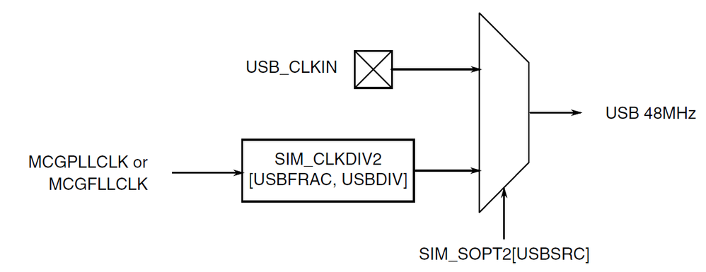

jeremyzhou
Hi Yuriy,
The USB FS OTG controller can't work normal when system clock frequency less than the 20MHz.
The controller also needs a 48 MHz clock and the clock options are shown below.
Ping

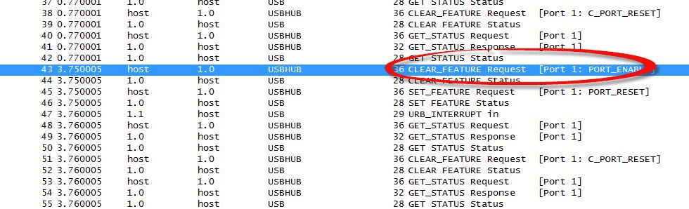

yuriydovgalyuk
I get USB logs using wireshark. See attached. Hope this can show something.
After few moments the MCU jumps into hard fault and everything hangs.
BR,
Yuriy.

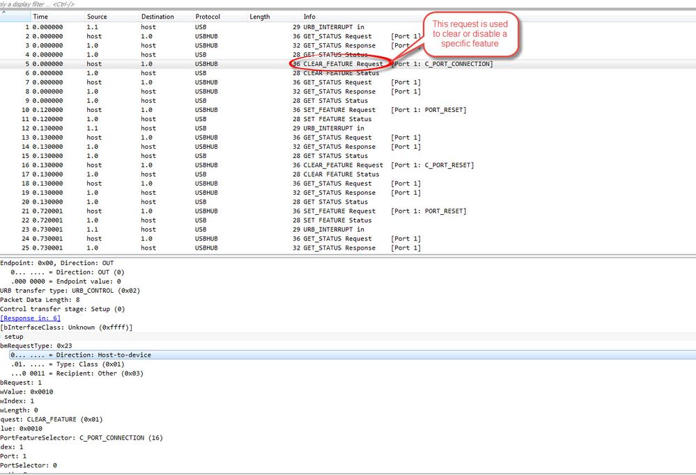

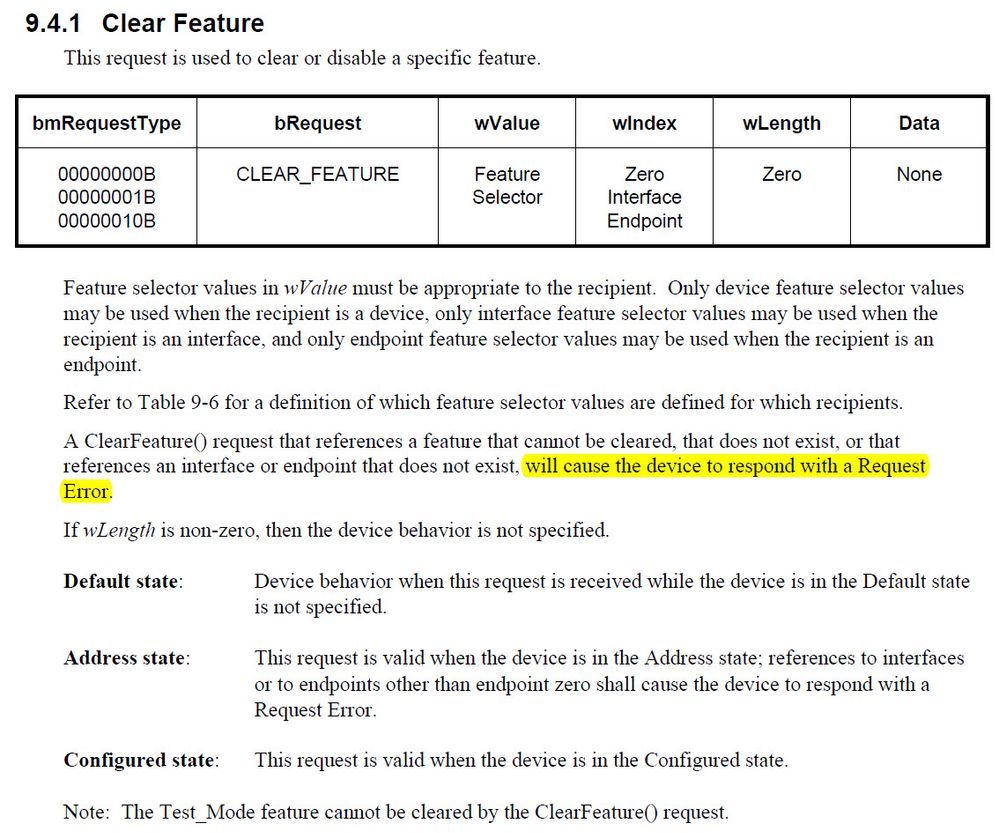

jeremyzhou
Hi Yuriy Dovgalyuk,
I've had a look through the attachments. According to the attachment, when use a USB cable integrate the PCB A with the PC will trigger PC send the Clear_feature request to the target (Fig 1),
then the MCU seems like to sink in a black hole and it will break down , in another word, MCU will become exhausted when it strive to make the enumeration pass after the PC send the Clear_feature request.
I've shared a paragraph about the Clear_feature request and please check it.

yuriydovgalyuk
Hi jeremyzhou,
Thanks for investigating the files.
So, you would suggest to debug in this function? Or...? Maybe I do not understand completely your point, but as I can see from logs MCU responds with SUCCESS to the CLEAR_FEATURE request.
Do you see more here?
In the usb_framework.c ( USB_Strd_Req_Feature function ) I found the following:
        else
            /* TODO */
            /* if the feature is 0, a request error need to be sent out*/
Could it be an issue?
I also attached file for the PCB B that runs fine.
BR, Yuriy.

jeremyzhou
Hi Yuriy Dovgalyuk,
I've been looking for the differences of the enumeration between the PCB A and PCB B for two hours.
The only difference is the host would send the clear feature to disable the Device_remote_wakeup function when PCB A enumerated, however it don't exist when the PCB B enumerated.
So I consider the the request break down the connection between the PC and PCB A.
But I've also not seek out the precise the error with the PCB A based on the screenshot you shared then would cause this issue until now.
