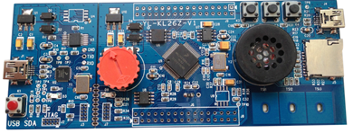

3.1 Hardware
      This document use the YL_KL26 as the testing board, customer also can add an external SD card circuit to the FRDM-KL26 board.
The board is using the TF card, SD SPI interface circuit is:
The pin assignment in the YL-KL26 board is defined as follows:
KL26 pin
SPI name
PTC4
SPI_CS0
PTC5
SPI_SCK
PTC6
SPI_MOSI
PTC7
SPI_MISO

    After download the code to the KL26 board, then insert a 8G microSD card which already format with the Fat32, press the reset button on the board, user can find the following printf log from the com port:
It means the SD card is identified.
     Now, take out the SD card and insert it to the PC, user will find there has two files: Test.csv and Test.txt. Open these files, data Test1, Test2, Test3, Test4 can be find in it,  it means the FatFs file system is porting successfully.
