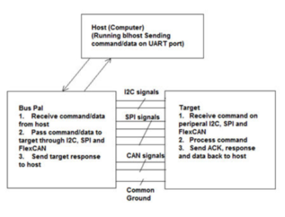

To connect bootloader via CAN bus, NXP has TWR-K65 as bridge. But its source code is not in K64 SDK. It is in MCUBoot2.0.0 package. User can download the package from https://www.nxp.com/design/software/development-software/mcuxpresso-software-and-tools/mcuboot-mcu-b...
The bridge project is called buspal which can be found in NXP_Kinetis_Bootloader_2_0_0\apps\bus_pal\MK65F18. BusPal is an embedded software tool that is available as a companion to blhost. The tool acts as a bus translator with an
established connection with blhost over UART and with the target device over I2C, SPI, or CAN, and assists blhost in carrying out commands and responses from the USB target device. The BusPal is available for selected platforms. The source code for BusPal is provided with the Kinetis bootloader release, it support FRDM-KL25, TWR-KV46F150M and TWR-K65F180M and can be customized to run on other platforms.
More detail of buspal is in Kinetis blhost User's Guide appendix C.

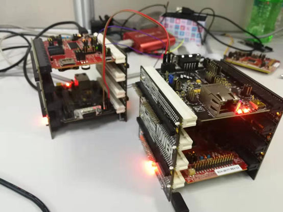

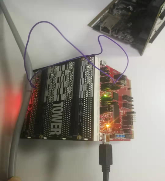

Hardware connection
TWR-SER has TJA1050 as transceiver. We can connect J7 on both boards. When construct the Tower system, user should take care the power. The power tree is very flexible. Improper setting may cause TJA1050 can’t work.
The Buspal project on TWR-K65F180M use UART1 to connect with computer. The port is on TWR-SER. To make the connection simple, we can share the openSDA UART port. The openSDA UART use UART2, we can jump UART1 signal to J33 and J34 on K65 tower board.
