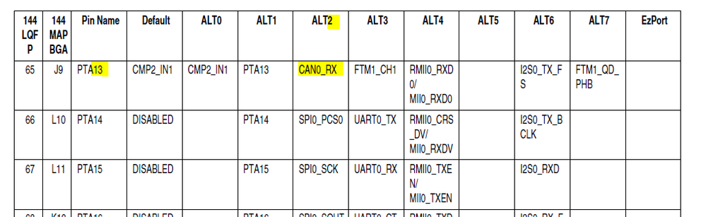

K60 Sub-Family Data Sheet, Rev. 3, 6/2013, section 8.1 provides a table with 10 different configurations for each pin, and states the PCM "is responsible for selecting which ALT functionality is available on each pin."  Simple enough, I want the ALT2 configuration according to that table. Is that one write to a PCM register or multiple writes? How do I decode what's in the table in 8.1 to lines of code? I see lots of examples in the forums where people suggest code snippets like:
     PORTC_PCR16=PORT_PCR_MUX(3);
I am using KDS and ProcessorExpert. I find a file called MK60F12.h under ProcessorExpert/lib/Kinetis/iofiles which has a collection of these #defines, so we have basically a statement with three arguments:
      PORTx_PCRy = PORT_PCR_MUX(n) ;
  • "x" in PORTx (for my chip, x is from the set {A, B, C, D, E, F})
  • "y" in _PCRy (for my chip, y goes from 0-31)
  • (n) in PORT_PCR_MUX(n) (PORT_PCR_MUX is a macro taking a 32-bit unsigned integer)
So it seems there might be a rather large number of possible combinations, but one would naturally assume there's some simple means of matching up Section 8.1 with the appropriate values of x, y and n for each ALT configuration? I don't find any further details in the K60 Sub-Family Data Sheet, nor in the User's Guide for the dev boards I'm using (NXP TWR-K60F120M and NXP TWR-K60D100M). Is there one "missing link" document that closes this gap?

To configure and use a port pin there are 3 things to do (if peripheral) or 4 if GPIO:
1. Enable the clocks to the port in question
2. Configure the peripheral/GPIO function
3. Configure the characteristics (pull-up/down/open-drain, driver strength, slew rate)
4. If GPIO, define the direction and state
The macro you show is for step 2.
Eg. to set PTA13 for CAN0_RX function it would be
PORTA_PCR13 = PORT_PCR_MUX(2);
This means that you need to look up the ALT function in the data sheet and plug it into the macro (it may or may not be portable between devices since sometimes the ALT number changes).

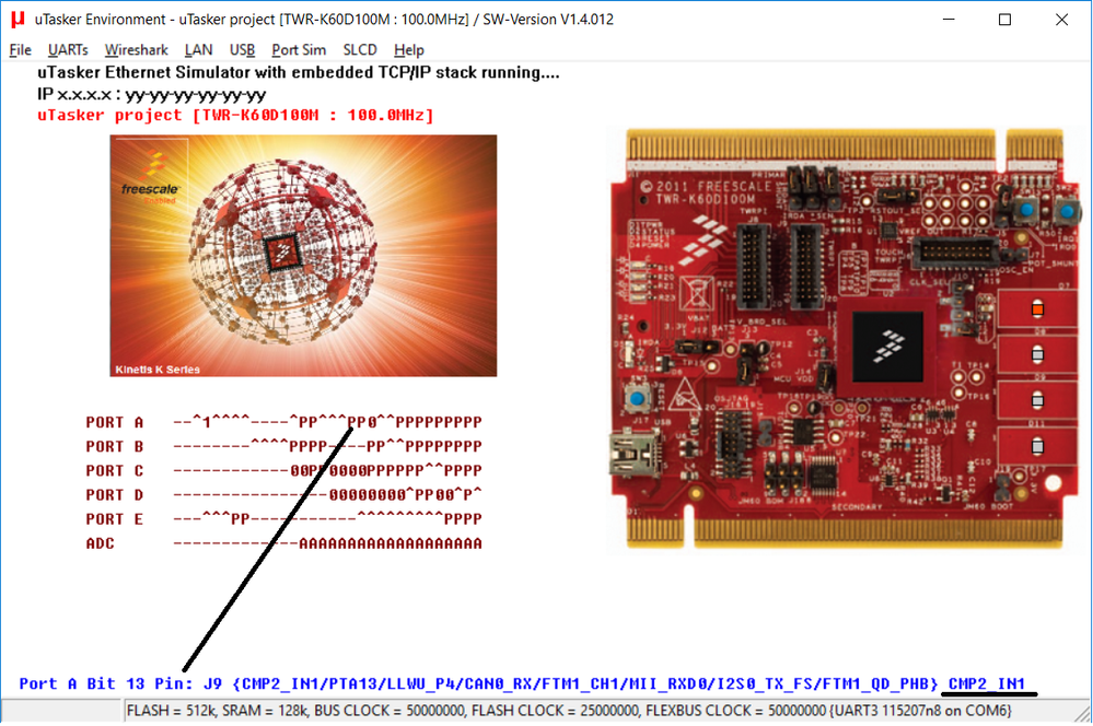

The uTasker project (see its macros at http://www.utasker.com/forum/index.php?topic=1875.0) is more user friendly and portable since it does it with
_CONFIG_PERIPHERAL(A, 13, (PA_13_CAN0_RX | PORT_PS_UP_ENABLE));
which handles all steps and makes it more readable and reduces error possibilities.
In the uTasker simulation the pin capabilities and actually programmed one are shown as below:
