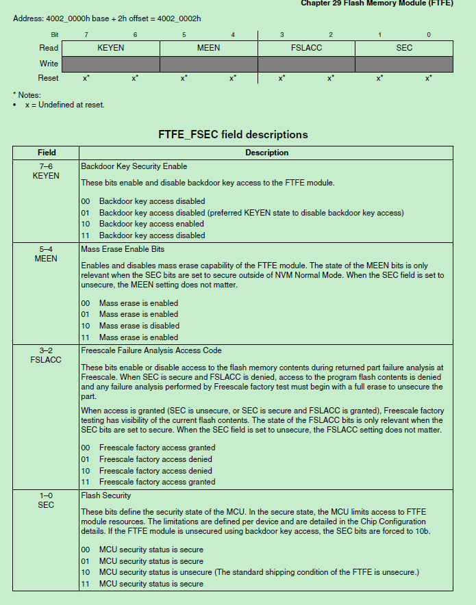

0x40c set to 0 or 0xff would be no different correct?
You just don't want bits 0 and 1 to be b10 -- then you made a brick.  The rest of the byte decides if the key is active, mass erase possible, NXP and read the device.

   The detail meaning of 0X40C data is in the FTFE_FSEC register:
    So, the data 0x00 or 0XFF in address 0x40c is the same, if you want to secure the chip, just make sure SEC bit is not unsecured(0b10).

    The most important data is the Flash configuration filed:
    The flash configuration field is in the bootloader area, so you don't need to afraid that the APP will modify it.
    Just make sure the 0X40D, 0X40C data is which you need, if you want to secure and enable the erase,  don't protect the area which you want to erase, and set 0X40C data to 0x03.
