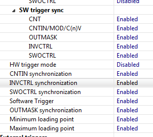

brunotremblay
Hi Alexey,
Thanks for your reply. Since I use the Init_FTM component, the only macros available are listed below. I don't have any general software trigger command. I tried with initializing all the software trigger with each trigger macro but the value still won't update. Can you tell me which bit in which register the "FTM_HAL_SetSoftwareTriggerCmd(FTM2,true)" macro take action?
Software trigger macros available:                                            Component initialization :
I found the "AN4560 PWM Synchronisation Using Kinetis Flextimers" app. note, maybe with that I will find something to help me.
Bruno

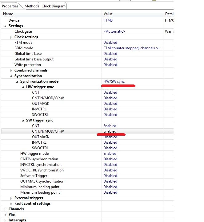

alexeyusoltsev
  Hi again!
Yes, this is very helpfull appnote.
Init component:INIT.jpg
and to send software trigger you need to FTM2_SYNC|=FTM_SYNC_SWSYNC(1);
If it will not work check in the debugger mode SYNCCONF register in the FTM.

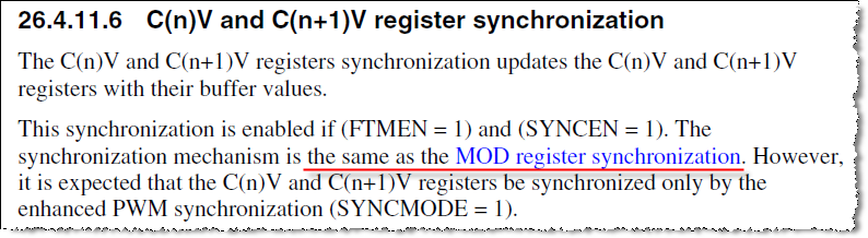

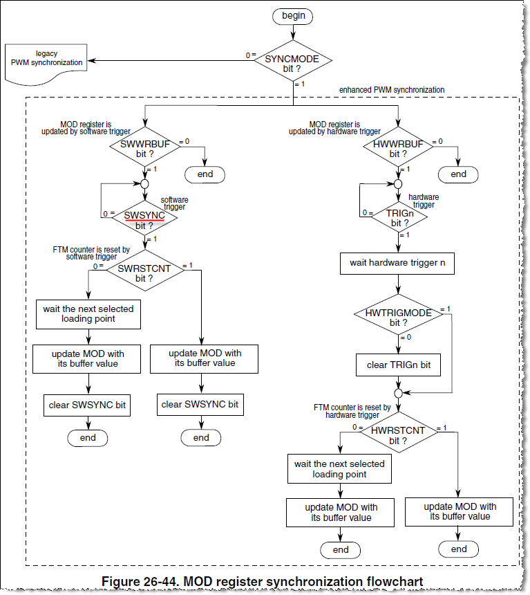

Robin_Shen
Hi Tommy,
If software trigger is initialized, FTM_PDD_PWMSoftwareTrigger() can be used to trigger "value update".
From the chapter "26.4.11.6 C(n)V and C(n+1)V register synchronization" in MKE06P80M48SF0RM we can know that: The synchronization mechanism is the same as the MOD register synchronization.
So see chapter "26.4.11.4 MOD register synchronization":
Robin
