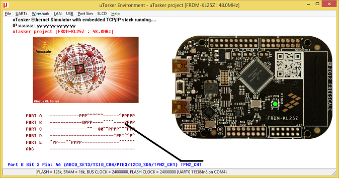

Attached is a binary which you can load to your FRDM-KL25Z.
It outputs the following three PWM signals:
- Timer 2 - channel 0 1kHz 20% high/80% low [PTB18]
- Timer 2 - channel 1 1kHz 29.4% high/70.6% low [PTB3]
- Timer 0 - channel 1 1kHz 29.4% high/70.6% low [PTD1]
Using the Virtual COM UART connection (115'200 Baud) you can use the memory debugging interface (in I/O menu) to check the TPM register settings and then correct anything that is not right  in your code.
Below is the simulation in the uTasker Kinetis simulator showing the PTB3 setting.
PWM interface used as described in http://www.utasker.com/docs/uTasker/uTaskerHWTimers.PDF
