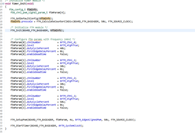

Hi! I am using FRM ke16z and I am generating with FTM PWM. I see on the oscilloscope the amplitude of the signal is 0.5 V . It seems to me pretty low. I need for controlling some ESC a pwm between 0 and 5V. What can I do?

I am testing the example frdmke16z_ftm_pwm_twochannel (SDK version 2.13.0) and probing the signal using an oscilloscope on LEDRGB_BLUE, it does output the PWM as expected
Maybe the reason you don't see the signal on the arduino pinout is that R9 is not populated by default.
Hope it helps you.

I see the signal but it has the amplitude of 0.5 V when is 1 and 0v when is 0. What do you mean with that R9. TY! @_Leo_

I mean resistor R9 that can be seen in the image that I attached. I consider that it is recommended that you try the example I mentioned above with another board, because I cannot reproduce your problem.

I dont get it with that R9. I should place a resistor? I give you code, it very simple.
And in main i just call the init and after that, in while(1) i call the board_updatePWM1. TY! @_Leo_
