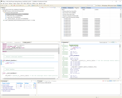

I want to set the PORTA1 and PORTA2 pins as communication pins for UART0.
I use code:
PORTA_PCR1 |= PORT_PCR_MUX(2);
PORTA_PCR2 |= PORT_PCR_MUX(3);
or:
PORTA_PCR14 |= PORT_PCR_MUX(3);
PORTA_PCR15 |= PORT_PCR_MUX(3);
The debug result is unexpected interrupt as showed on snapshot:
When I use other than PORTA, e.g. PORTE, there is no issue.
Why PORTA causes issue and how to solve it?
Stano.

Did you enable the clock gate of PORTA? SIM_SCGC5[PORTA]
Maybe the clock gate of PORTE was enabled somewhere.

yes, the clocks for PORTA are enabled. I tried many variants, but PORTA differs. Other ports function well.
Thank you for your recommendation, I will check it.
But I would like to understand the core of issue - why the write instruction to PORTA_CR differs from the same instruction for other ports in MCU. I want to know "how it works" and where is the difference. Where it is described?
Stano.

The value of PORTA_PCR are all 0x80008000 seems strange. And please check the register value of SIM_SCGC5[PORTA].

Issue is solved, it was caused by stupid mistake in port clock settings.
