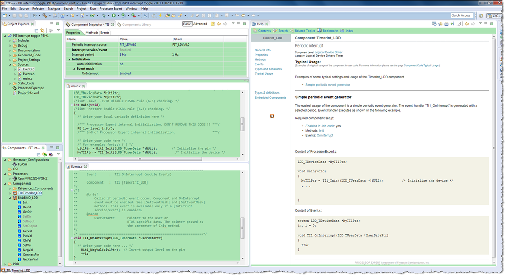

Robin_Shen
Hi Abdul,
Please test the attached 'PIT interrupt toggle PTH1 KE02 KDS3.2 PE' example.
Robin

abdulhayee
Thanks Robin for your help..as i am learning ARM processor and pointers and structure make me so much confuse. Can you give me an example without using PE (processor expert) tool? simply by accessing the registers directly.
