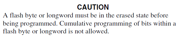

You cannot modify a long word once any bits in it have been set to 0.
This is a standard characteristic of the Flash used in all Kinetis parts (although some can't modify within an 8 bit phrase) and is clearly indiated in all user manuals:
The effect that you are seeing is probably due to EEC operation (although I don't know for sure since there is no documentation on the internal workings) whereby each write entity is saved with an EEC value (not visible but also in flash) when it is programmed which can correct an error (allowing smaller flash structures with lower reliability but offset by error correction). When the long word is changed it is no longer possible to change the EEC that was saved the first time and now when the Flash entity is read the EEC tries to correct bit(s) that no longer match and so you read back wierd values.
When the same incorrect utilisation of Flash takes place on some of the larger devices (like K70) the effect is that the read back phase causes a hardware access error (rather than just strange values) which is only corrected when an erase of the sFlash sector is performed.

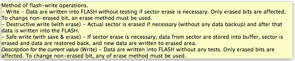

That said, I was under the impression from the Processor Expert config help that the "write method" = "write", would disable this type of error checking.
Here is the help info that comes up:
Apparently there is more going on below than I first assumed.
It is curious that the 32-bit long-writes are working exactly as I assumed the byte-writes would have.
If there are any freescale engineers on the board who can point me (us) to a more in-depth description of the flash controller implementation, I would greatly appreciate it.

There is in fact no such thing as a byte write for the Kinetis.
A byte write in a SW interface will only be positioning the byte accordingly in the long word and writing the long word with the other bytes set to 0xff. It still can't physically write more than one byte in a long word of Flash (in the KE part).
