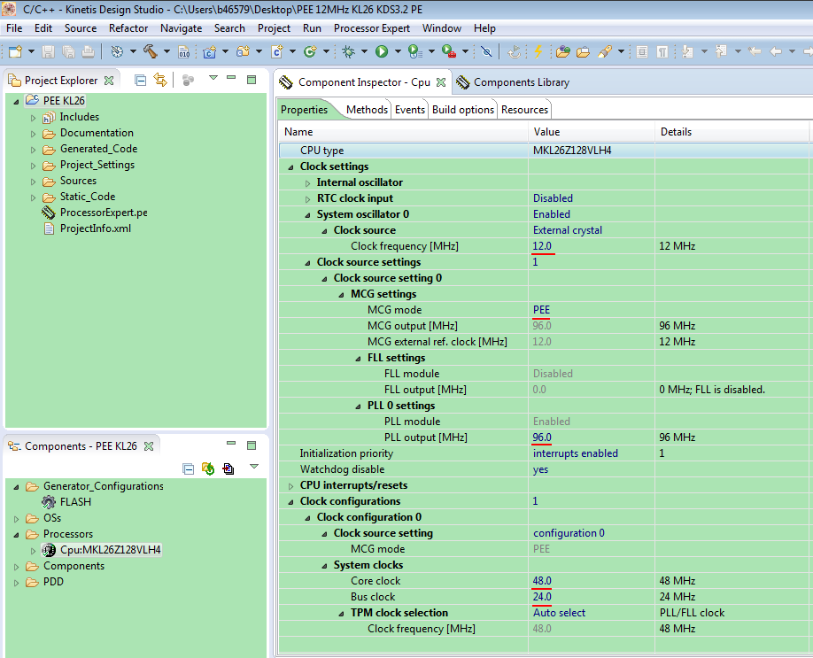

clock mode is PEE, 12MHZ crystal. init code is generated under PE, External crystal doesnot work , and program halts at "while((MCG_S & MCG_S_IREFST_MASK) != 0x00U) " //Check that the source of the FLL reference clock is the external reference clock.,  this is why?

Robin_Shen
Hi junwang,
I am using KDS3.2 with Processor Expert, please refer below setting.
If the program still halts, please observe the waveform of XTAL0 and EXTAL0 pins by using oscilloscope.
Make sure the crystal circuit is well soldered.
Robin
