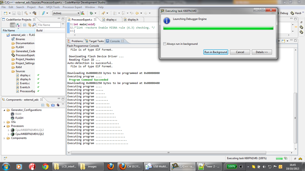

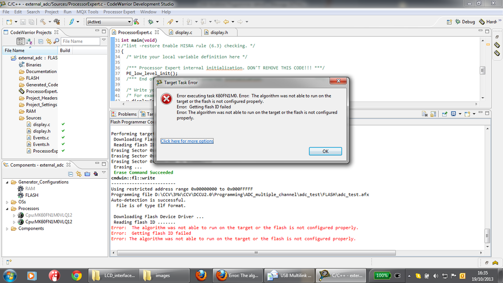

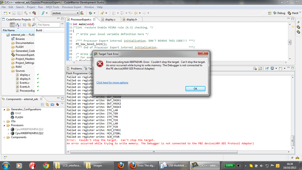

Hello everyone,
We have recently purchased a PE multilink universal programmer and are facing some issues with it.
Firstly as per the manual we had to upgrade to the latest firmware to support out K60 controller.which we did and the firmware was updated successfully.
But when programming/debugging in code warrior(10.3) we get a series of errors in the console.On repeated tries it finally programs and the code executes accordingly.But its mostly on a trial and error basis.We would like to sort out this issue as soon as possible.Is it a problem with the programmer or is my flash not configured correctly?Please Help..

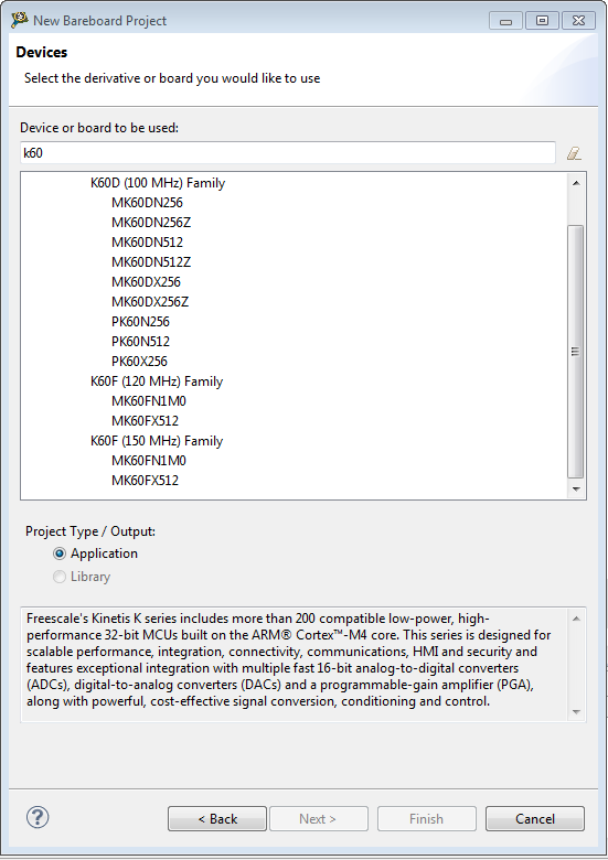

hectorsanchez
Hi Arun,
What Pavel suggest is to check the k60 you are using, make sure your k60 is correctly selected from this list when you make the project.
3,900 Views
arunkumar1989
We are using the Kinetis 60 series  MK60FN1MOVLQ12.
Yep i did check the name in my workspace and i have selected the very same controller.
@Pavel : I checked the physical reset line and there is continuity between them as well.

But after frequent trials i can tell at which point it is programmer is hanging/showing error by checking the console logs:
Executing program ....       ->Programmer hangs
Performing target initialization ...     ->Error pops up
Erasing ...     ->Programmer hangs
Reading flash ID ...     ->Error pops up
