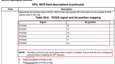

I have a remarkable behaviour for the DSPI. Using a KV58 tower .. The example from the SDK is just working normally. I can select the CS0 polarity.
I have my application using a driver SPI just as a copy paste. And the CS0 is always active hi.

The surprise here is the line
SPI0->MCR |= (0x003F0000);
needs to be there .. After the inizialization despite the explicit setting to have a low active CS the CS is always active high. But the procedure is the same in the SDK. So
explain me what is wrong.

Hello @pietrodicastri
Please refer to the PCSIS field in the SPIx_MCR register. When a bit is set to 0, the inactive state of PCSx is low, and high indicates the active state. Also note that the effect of this bit only takes place when the module is enabled. Ensure that this bit is configured correctly before enabling the SPI interface.
Alice
