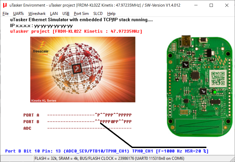

mjbcswitzerland
Specialist V
See also
https://www.utasker.com/docs/uTasker/uTaskerHWTimers.PDF
https://www.utasker.com/kinetis/FRDM-KL02Z.html
Available as open source on Git Hub "uTasker" including KL02 support and simulation - eg. generating 1kHz 20% output on PTB10:
Mark
[uTasker project developer for Kinetis and i.MX RT]
