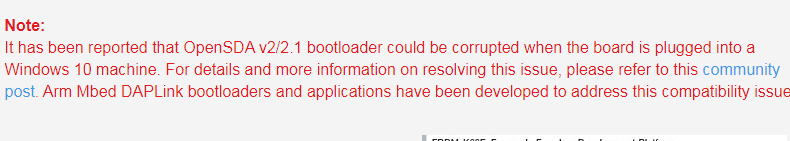

I have a FRDM-K66F.
Yesterday the board was still ok.
Today if I connect to my win10, there started the "Bootloader" Menu.
I would stop this and found this thread
Can't turn off bootloader
and so I started the update
OpenSDA Serial and Debug Adapter | NXP
after step3 I unplugged the board und plugged again.
Now the status POWER LED is off and there is no Bootloader Menu and no communication.
What can I do? I need help
If I connect the USB to "Micro USB" my last Programm is still running.
7 Replies
4,159 Views
kerryzhou
Hi ronny neupert,
   The FRDM-K66 on board opensda is the old version opensda v2/2.1, it has the problems in the win10, please check it from this link:
https://www.nxp.com/design/microcontrollers-developer-resources/ides-for-kinetis-mcus/opensda-serial...
So, you need to find the external debugger, eg, JLINK, download the newest opensdsa 2.2 to your on board K20 chip.
https://www.nxp.com/assets/downloads/data/en/snippets-boot-code-headers-monitors/0244_k20dx_bl_0x800...
Then download the latest firmware in bootloader mode.
Then, you can make your board works again.
Kerry

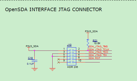

Is there an other way to flash the .bin to the device.
I have no a Debugger device for the SWD pins.
4,159 Views
kerryzhou
Hi ronny neupert
      You need to find an external debugger, eg JLINK, then download the new bootloader to the K20 chip through SWD interface:
     Do you already do it? You did this way to recover your on-board opensda.
     Or, do you any other freedom board? You can use other freedom board firmware with JLINK, then use the other freedom board JLINK debug your FRDM-K66 on the win 7 .
Kerry

ronny_neupert
I have a last question, do you know I can use the OM13054 ( LPC-Link2 | NXP ) for flash the *.bin file over the J10 pins to the K20. So I will buy this.
Many Thanks.
4,160 Views
kerryzhou
Hi ronny neupert,
  Yes, LPCLINK2 can support the K20 code download, LPC-LINK2 can use CMSIS DAP and Segger JLINk, you can use it.
