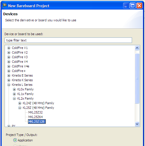

Hi Antonio, the first error screenshot leads me to believe you might have selected the wrong package while you were creating your project, please make sure you are selecting the MKL25Z128 variant as shown in the image.

That was the first thing I had checked. Target was correct. Also, other projects that were previously loading presented the same errors.
I tried the same projects in my home computer, and they loaded without any problems. Thus, I supposed that CW installation in my office computer got corrupted somehow.
I reinstalled my CW10.3 Beta in my office computer, and the problem did not occur anymore.
