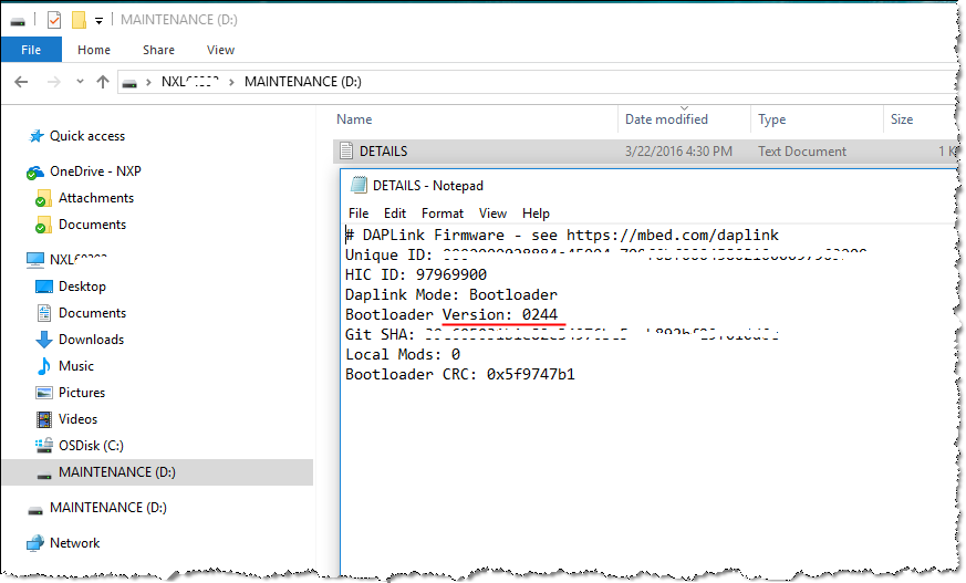

Please check the version of the DAPLink bootloader or interface firmware in the DETAILS.TXT when the device is mounted as MAINTENANCE or DAPLINK.

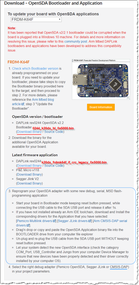

I am using the DAPLink rev0244 OpenSDA v2.2 Bootloader(0244_k20dx_bl_0x5000.bin) and DAPLink rev0244 firmware application(k20dx_frdmk64f_if_crc_legacy_0x5000.bin) download from OpenSDA Serial and Debug Adapter|NXP.

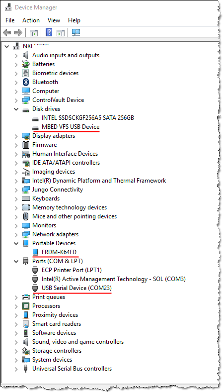

After firmware application is installed, you should be able to find it in Device Manager.
