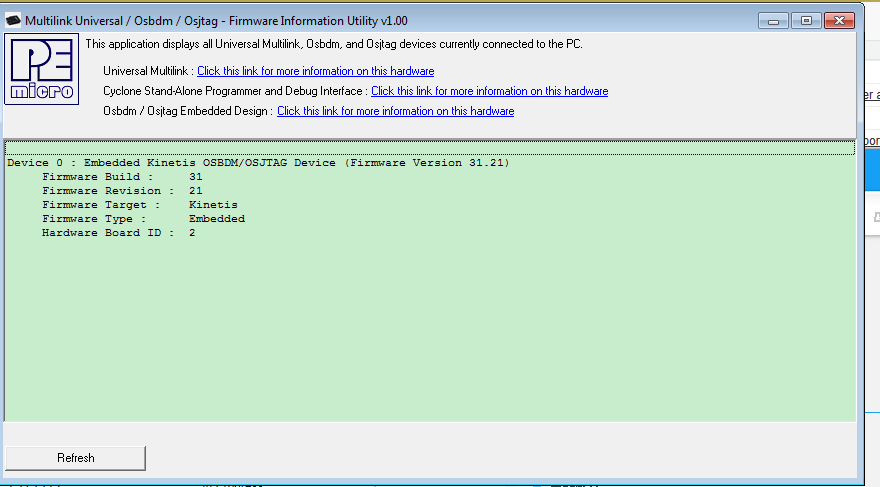

* After updating the OSBDM/OSJTAG firmware to version 31.21, I can see three drivers as expected:
----  Jungo                                -> WinDriver
----  LibUSB-Win32 Devices   -> Open Source BDM - Debug Port
----  Ports (COM & LPT)          -> OSBDM/OSJTAG - CDC Serial Port (COM16)
* However, "Terminal Utility" of "OSBDM OSJTAG Virtual Serial Toolkit" is not working anymore!
--- because "Open Serial Port" always fail.

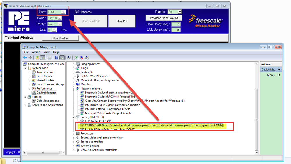

Hi Jerry,
   Yes, I have test it on my side.
  You said your com port is COM16, but you didn't select the COM16 in your terminal window.
   This is the screenshot from my side.
The port just have COM1-COM8 to select, so you need to modify your com port number to COM1-COM8 in the device manager.
Wish it helps you!

jerrylian
Hi, Kerry:
From "P&E Micro" company website, I have downloaded:
* firmware_updater (Date: 10/26/2012)
* osbdm_osjtag_virtual_serial_toolkit (Date: 4/27/2011)
* PEDrivers (Dates: 2009-2014)
Installation of those software did NOT solve my problems.

kerryzhou
Hi Jerry,
Wish it helps you!
Kerry

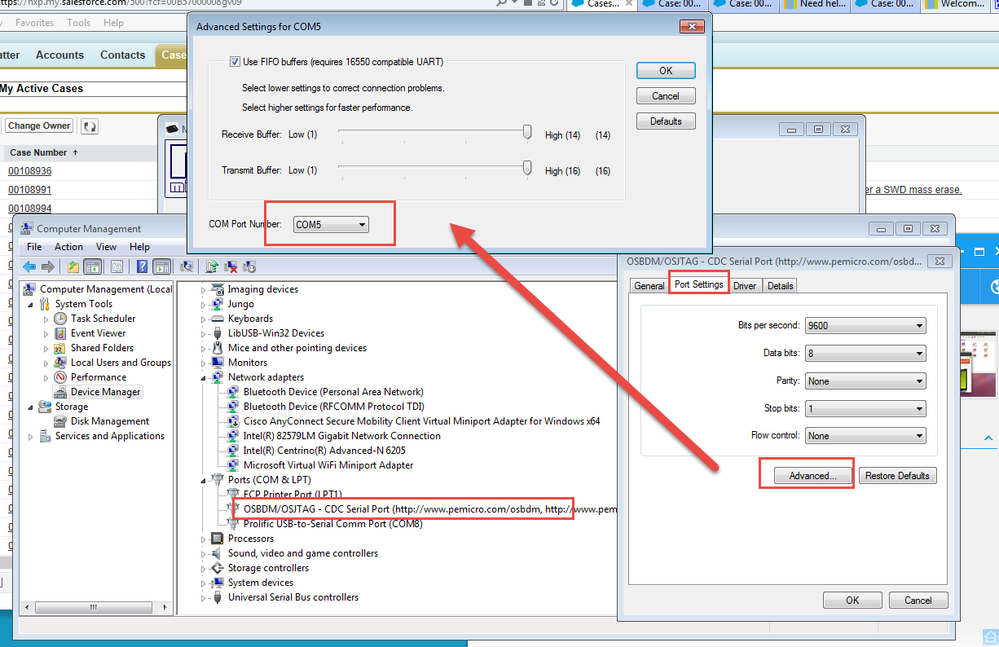

jerrylian
Hi, Kerry:
Thanks for your detailed instruction.
* In my computer, COM1-COM15 are all "in use", so P&E port uses COM16.
* In Virtual-Serial-Toolkit, we can only choose COM1-COM8, USB-COM. And USB-COM is confusing:
--- With old version of OSBDM/OSJtag firmware, we just use USB-COM by default.
--- But for new version of OSBDM/OSJtag firmware, USB-COM becomes meanlingless.
* So it is a bug of Virtual-Serial-Toolkit, they should include all COMs, or allow us to input manually.

kerryzhou
Hi Jerry Lian,
    Don't worry about COM1-COM15 are all "in use", if ports in the device manger don't list it, you can change you COM16 to the not list COM number.
    About the toolkit bug, it is from the P&E micro, you can report to them, but I think it doesn't influence the usage after you change the COM port to COM1-COM8.

jerrylian
Hi, Kerry:
You right, I googled that "in use" COMs may not be actually in use, and the fake "in use" status can be reset by appropriate operations.
Thanks for your great support!
