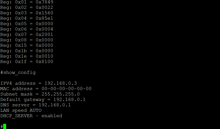

otavioborges
Thanks mark,
I uploaded the uTaskerV1.4.8_FRDM-K64F_LAN.bin​ binary through mbed bootloader. I was able to access terminal application from utasker and went to LAN configurations, it had 192.168.0.3 IP (wich was on my subnet domain) and the correct gateway. Nonetheless, LAN did not work, green led did not lit once, I could not access the WEB server, even after I enabled it. The strangest thing is that I had 00-00-00-00-00-00 for MAC address. Is this a sign for bad ethernet interface? I tried changing the phy register without success. The attached image has a screenshot from the utasker terminal

The MAC address defaults to 00-00-00-00-00-00 but you can program a value in the LAN menu using the (secret command)
MAC 00-00-00-01-02-03 (for example). This will be saved and the board resets, after which it uses the new/final MAC address.
My feeling is that you have either a HW problem with the board or else with the cable being used. Attached is a version which will also display the state of the connection as follows:

Notice that the PHY registers change content when the cable is inserted and the values that you show are those when there is no cable connected!

Tried changing the cable and register 0x01 did not change.
PHY seems to be working (did a little check on the datasheet), I checked the signs on the RJ-45 and did not find anything unusual.
I'll try to unsolder the connector and put a new one.
