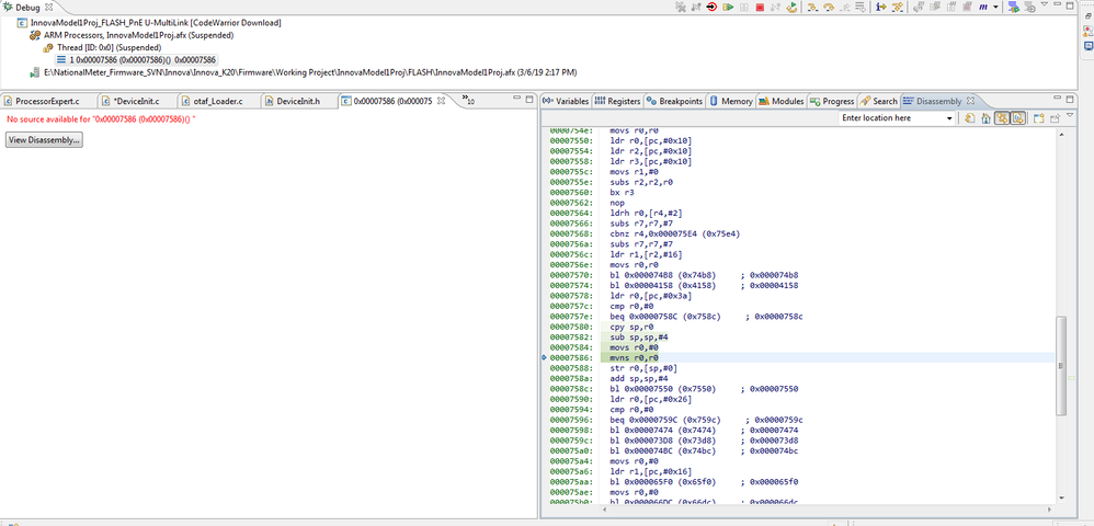

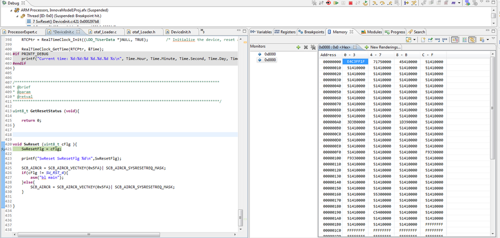

I am working on NXP Kinetis K20.
My Application Code is at 0x8000.
My Bootloader code is at 0x0000.
But When I am Reseting my Device as shown in Screen shots, the code is not behaving as required. As Program Counter is correct.
Please help me in this I am very much under pressure.
To Reset I am using SFR:
SCB_AIRCR = SCB_AIRCR_VECTKEY(0x5FA)| SCB_AIRCR_SYSRESETREQ_MASK;

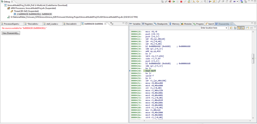

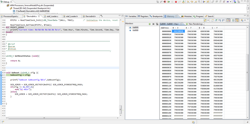

This are the screenshots...as you can see the PC is correct but still it goes to unexpected location.

1. It is MK20DX256VLL7.
2.Both Bootloader and application working independently without any problem.
3. The problem arises when I am doing a Sw Reset to Start the code from 0x0000 instead of Main(); ,i.e., 0x8000.
I dont know how to go more deeper, as I think it is SFR issue, but clueless on how to find the issue.
