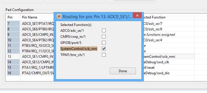

ralphdeffke
I did, but this is a multi pin MCU.
I am using the 16pin QFN version so many info given are not for me. I was hoping to get help in filtering what is relevant for me.
I fired up the MCU professor in the IDE and see the pins I can configure for the reset, clk and data pin.
Am I completely free to choose from the selection or there are any recommendations on that little chip ?
And what are the pin SystemControl/scb_nm for ? the manual it doesn't find that term.
thanks
Ralph

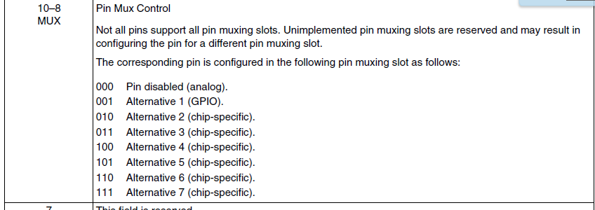

Hello Ralph,
Yes, you need refr to the Pinout Joey mentioned , then configure the register of PORTx_PCRn -> MUX :
Hope it helps
Alice
3,340 次查看
joeygouly
Normally there is only one option for reset, clk and data pins per MCU.
In the reference manual here http://cache.freescale.com/files/32bit/doc/ref_manual/KL02P32M48SF0RM.pdf
Look at section 10.3 Pinout. It will tell you which pin is used for which function.
