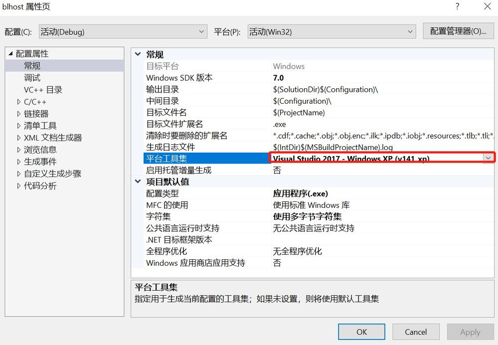

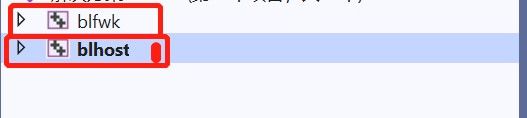

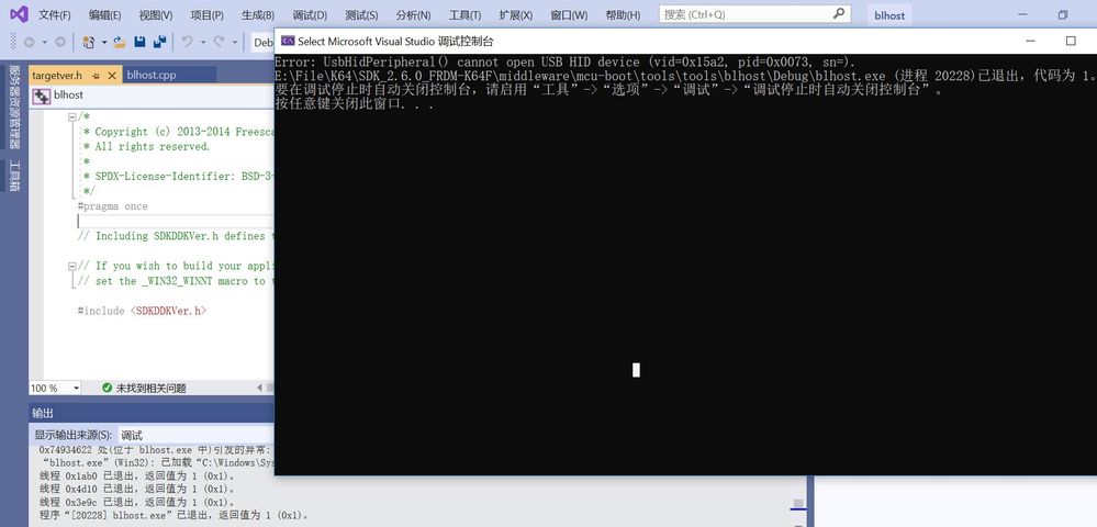

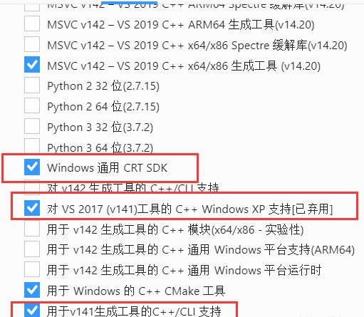

The blhost source code in SDK can be run with 0 error,but you should config your VS first.
