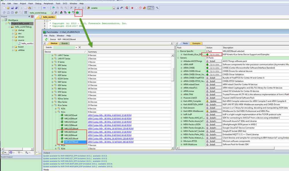

kerryzhou
Hi Bruce,
   Do you install the MDK pack at first?
   Please check the following picture:
You need to add the pack at first, then your problem will be disappear.
You can install both the KL16 and KL26.
Please try it at first, if you still have question about it, please kindly let me know.
Kerry

64,821件の閲覧回数
bgraham
Keil uVision 5.26.2.0
When I create a new project using the Keil::Kinetis_KLxx_DFP pack 1.15.0,
I get a project with no devices.
When I create a new project using the NXP::MKL26Z4_DFP pack 10.0.3, I get a
project with all of the MCU's devices.
See below.
What is going on, and how do I correct it?
Bruce
NXP::MKL26Z4_DFP
64,815件の閲覧回数
kerryzhou
Hi Bruce,
  Please check your this picture:
When you open the project, can find the device, then just select the chip manually, then press OK, then your project will have the part number.
At that time, you can build it again.
When the above window pop when you open the project, just select the chip which you are using.
If you still have problem, just let me know.
Kerry

bgraham
This website is not placing my images within the body of the text.
I downloaded the Keil::Kinetis_KLxx_DFP packs 1.1.0 through 1.15.0.
I looked in directory C:\Keil_v5\ARM\PACK\Keil\Kinetis_KLxx_DFP.
None of the sub-directories contain a pack drivers directory.
Clearly, there are no pack drivers, so there is no support for the MCU.
I looked in the directory C:\Keil_v5\ARM\PACK\NXP\MKL26Z4_DFP\10.0.3\drivers.
The drivers directory contains c files (drivers) for the MCU's clock, dac, adc, dma, etc.
Is the pack is broken?
Or is NXP not providing support?
Bruce
