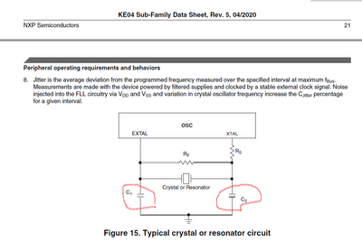

In a project where we use NXP MKE04Z128VQH4, we are having MCU reset problem.
When we check the SIM_SRSID register after reset, the reset cause is seen as ICS loss-of-clock (LOC). However ICS_C4[CME] is not set.
Can you help with the cause and solution of the problem?
Information about the design can be found below and in the attachment.

I see that you connect 8MHz crystal to the XTAL/EXTAL pins for KE04.
1)I have checked your crystal connection, you do not connect the capacitors as the following Fig.
2)You set the OSC_CR[RANGE]=1, OSC_CR[HGO]=0, so you use high frequency,low power mode.
Pls try to set both the RANGE and HGO bits and have a try.

MCU was waking up and going back to sleep every 25 seconds, so we reduced this to 2 seconds to replicate the error. At the end of the test, we saw that the processor entered a hard fault. We added while into the hard fault function and debugged it with Attach to Running Target.
After turning off the timer clock(SIM->SCGC &= ~0x2u), we saw that ISR_pit_ch1 (timer interrupt)(PIT->CHANNEL[1].TFLG |= 0x1u) came and this caused the error. Do you think LOC reset could be related to this problem?
Thank you for your support.
