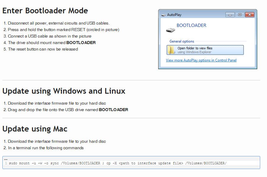

Hui_Ma
No need to change the bootloader image.
Please refer below picture to update the OpenSDA firmware to J-Link firmware:
Wish it helps.
Ma Hui

lucasmahieu
I did it this morning, and now i see a "j-link" devis on my destop,
But how a can put my programm .srec or .hex in the frdm ?
