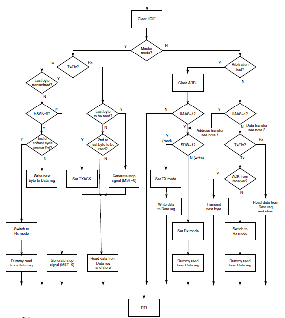

With help from the Freescale team I was able to get a single register read working perfectly, my code is below. I was wondering what would need to be changed/added to make it a multiregister read. Think of the MPL3115A pressure registers, looking to read 3 or 4 registers without needing to start a new read cycle for each register. I have been able to get two registers but no stop bit at the end. and help would be much appreciated.

The user's manual show you how to do this. Just copy the flow chart that it gives:
Since you are not using interrupts just spin waiting for the IICIF - then enter the flow diagram and either loop back to waiting on the flag, or quit when all is done.
Generally however consider using interrupts so that the processor can do other things in parallel (unless doing this in a low priority task under a pre-emptive operating system).

Thank You Mark,
But again as with my first issue here stating the obvious does not help. The above flow diagram is pretty much useless as accurate order and timing are missing. Example of such iris when is the TXACK set, before or after receiving the second to last byte same with the MST = 0. Also there is no mention of timing. After all is said and done all I was missing was a time delay after receiving the final bit before setting MST = 0, there is NO mention of this anywhere in the chapter on I2C. Anyways all said and done I have it working now but this is one BIG issue I have with Freescale is their appalling documentation due to its ambiguity.

Kas
There shouldn't be anything that is timing specific and I also believe that the ordering of setting TXACK and clearing MST is clear in the flow diagram - (TXACK/MST first then read the rx data byte).
I have used the I2C quite intensively in the Coldfires and Kinetis (they are about the same) for 8 years or so and never used any delays. It may be that you have missed clearing the status flag (I2C0_S |= I2C_S_IICIF_MASK) between starting  the last data byte read and then sending the stop condition and so the delay is compensating for the fact that the final wait (while ((I2C0_S & I2C_S_IICIF_MASK) == 0){}) is not working since the flag wasn't cleared.
Otherwise I think that the code I use (uinterrupt driven) follows the recommendation.
There are two details that are possibly missed in the present documentation which trips people up (in standard master mode):
1. The fact that the bus can lock up when the processor is reset during a slave ACK
2. The fact that one needs to be careful about starting a new transmission when the stop bit of a previous transmission hasn't completed

I can't follow the code that you posted above. There is some reading code in the main loop but other reading code in readRegister (with the new delay) but it is not being called to see what is happening afterwards (which could be affected the the delay before returning). There are also new functions like i2c_Wait() with no code showing what they do. There were originally  also delays with no obvious purpose, such as
  for (j=0; j<5000; j++){};
As noted previously, code with delays and no comments (explaining why they are needed, plus pointing to the detail in the chips data sheet, user's manual or errata) are often not needed and were added "in desparation" by someone who found that it changed things enought to stop an 'unwanted' behaviour. There are some valid delays that are required (eg. the data sheet may point out that some operation is not possible until a peripheral has completed an internal reset or synchronised to a different bus, which can take a maximum number of clock cycles or us) but not usually in interrupt or flag driven peripheral drivers.
Workarounds of this nature can fail when conditions change, or bus clocks or peripheral speeds are adjusted, or a different device type is moved to and so are potential code-bombs that can go off at some time in future and require a proper solution to be worked out.
Below I have attached the I2C interrupt code for the reception case from the uTasker project as reference but I don't see any basic difference to the order of operations (most of the code is for the I2C driver's state and rx circular buffer). The transmission of the first byte is not shown because that is not in the interrupt but it is only sending the start condition and the first byte.
Mark

kaslewis
Mark,
I was able to remove all delays from my code with a bit of work thank you for pushing me to do that :smileyhappy:, I had everything working but I now have some odd happenings as I have outlined in a new question thread. I have also posted a full copy of my code there (with comments) if anyone wants to have a look how I finally got my code to mostly work.
Kas
