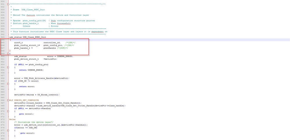

This shows up in several places, most severely in usb_phdc.c, at lines 844-849.
    devicePtr->user_handle = *phdcHandle;
    #if USB_METADATA_SUPPORTED
    devicePtr->phdc_metadata = FALSE; /* metadata feature disabled */
    #endif
    *phdcHandle =(unsigned long)devicePtr;
phdcHandle is described as an OUT parameter, meaning that it points SOMEWHERE valid, but the contents are unlikely to be anything useful.  This means that the assignment at line 844 is likely to store garbage in a well-defined place.
If the two assignments are reversed in order, garbage is not stored.  Instead, devicePtr->user_handle points to itself, which does not seem particularly useful, since you would then have devicePtr->user_handle == devicePtr.

Hi John,
I am sorry, but which version are you referring to? I just checked usb_phdc.c in KSDK 1.1, the line 844-849 is not what you mentioned above, so would you please help to clarify?
Kan
2,575 Views
johnstrohm
USB_STACK_V5.0: USB Stack v5.0-Beta Freescale bare metal (no OS) USB Stack, freshly downloaded from USB Stack|Freescale
I just pulled a brand-new copy, and verified it.
The lines in question are about 70 lines down from where your version shows line 844.

Kan_Li
Hi John,
I just got the feedback, and the software team told me The code of PHDC init is wrong, actually user_handle is obsolete and should not be used. so in the later version usb_handle will all be commented. Thanks for your reporting!
